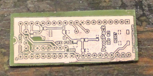

I like being able to quickly breadboard an Arduino and would like to do the same for the Propeller -- the support components make this a little harder.
Solarbotics makes a pcb that sits on top of a 28-DIP AVR chip (The Ardweeny: http://www.solarbotics.com/products/kardw/). It uses 0.1" pin headers that you solder to the chip pins. It's really handy and makes for a small, standalone footprint.
So I got the hair-brained idea to do the same for a Propeller. (Maybe someone already did this but hey it's fun) I drafted up a schematic and board design using SMD components (except the xtal) and have some parts on order from Newark and Sparkfun. The initial design is for a built-in FTDI usb-serial adapter. If that doesn't work I guess I'll put a prop plug 4-pin header on it instead. But anyway...
Eagle files: http://code.google.com/p/prop-pack/
I'm entering exciting new electronics fab territory here... :D Will I be able to use iron+laser printer to make 0.016" traces at home? Is it really possible to do SMT reflow in an electric skillet? Tune in next time... :D Will post updates if I actually pull this off...
Here's the schematic and board:
LMK if you see any issues with the design...

    I would suggest you add a pull-up to the SCL line. No, the Propeller doesn't need it, but if you want to connect another I2C device this takes care of the requirement (assuming you want to "play nice" per the I2C spec and not drive the SCL line high).

    Looking pretty good. It may be worth putting in two bypass capacitors. 0.1uF. Put them as close as possible to the propeller power supply pins.

    Ya, Dr_A is right about those by-pass caps ... add one for the FTDI chip if you can. While you're at it, may as well add pads for a 10uf 10V tantalum cap for extra by-pass to make the over-clocker's happy. Since you have little room on the top side, put the caps on the bottom.
    I've been looking at the FTDI stuff, and have decided to use board power for the VDDIO pin instead of 3V3OUT. That way the chip won't try to power your entire target breadboard when the target power is turned off. If you follow this method, you should add the board detect voltage divider for RESETn. Without the resistors the device may not auto-identify when connected. Look at the FT232RL spec.

    Here's an update with pads for a 10uF 0805 cap, as well as a pair of 0.1uF and 1uF caps at each power pin. I added the other 10k pullup for i2c but had to add a jumper wire to do it so's I can still etch this board at home to test.
    I ditched the FTDI chip and added a Prop Plug header and Sparkfun FTDI breakout board header. I figure if anyone wanted to make this board or go in with me on one, they'd probably have (or could justify getting) one of those two programmers. Losing the FTDI, etc. makes the component cost cheaper and the board less crowded.

    You don't need a 1uf and 0.1uf cap on each power/ground pair. Just 1 cap per pair is enough. Also, SMD resistor arrays can be almost as small as an 805 and are easy to solder for pull ups.

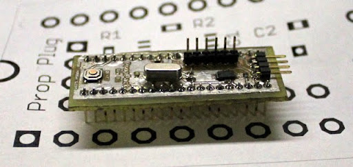

    Well, I fabbed up the first prototype. Transfer and etch of the 16 mil traces was no problem at all. And the TSSOP chip worked. But I officially hate TSSOP and will switch to SOIC on future versions. :)
    I stupidly put the EEPROM on upside down and fried it so now I have to order another.
    I agree the Ardweeny looks hacked. Mine won't win any aesthetics contests either. :( My goal was bare bones, rapid, ultra-cheap prototyping.
    Parts cost around $2.50 per board (ordering from Newark) + shipping. Haven't priced Digi-key (where you can get free shipping). Board, around $4.50 plus $10 per run for S&H thru BatchPCB. The board is still single layer so a home hobbyist could do their own and save some bucks.
    I designed an all through-hole version which would be cheaper for most folks since they have a stockpile like me. And it would be more accessible to a home hobbyist. Maybe I should go that route.
    I looked and looked for 20-pin stackable headers. No dice. If you find some, let me know.
    Once I get my replacement EEPROM I get to actually verify that the thing works. :)
