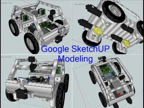

Hello everybody,
I’m here to share with you my new project “Nikos 4WD Rover”. attachment.php?attachmentid=76120&d=1291590052
I would also ask for your help, your advice, your suggestions and your feedback!
My inspiration for this project basically was the “Motor Mount and Wheel Kit with Position Controller”.
and the "HB-25 Motor Controller". ”. I have also spent a lot of time looking at "Madeusa - Robot Base Full Kit” and I was trying to understand more details for this robot and take some ideas. The major help however comes from the project:"TOBI - The Tool Bot ”. This project really gave me a lot of useful information and helped me to overcome my hesitations.
So I decided to buy two “Motor Mount and Wheel Kit with Position Controller”.
because I had a crazy idea. I had decided to create a mini 4wd rover. Actually deep in my mind I had an ambition. I had dreamed of building a robot similar to " Propeller QuadRover Robot ”! The little brother of " QuadRoverRobot” was something beyond the imagination but similarities based on the external appearance of this robot were practicable.
At first I had no Idea If I could control 4 wheels using only two HB25. So I asked help from the Parallax support team. I’m thankful because they answered my question about the connection topology. (Thank you Dave!!!) (But now I have a lot of new questions!)
I have also done the 3d Model of this Robot using the Google SketchUP software. So I provide you the eDrawing model to share with you all the details. "(Download the viewer to view 3D files)”
Here are the electronic parts I used and the cost:
1) (1) [URL=" http://www.parallax.com/Store/Microcontrollers/BASICStampDevelopmentBoards/tabid/137/CategoryID/12/List/0/SortField/0/Level/a/ProductID/126/Default.aspx"]" Board of Education Development Board ”[/URL] (USB)$69.99
2) (1) " BASIC Stamp 2e Module ” $54.00
3) (2) "HB-25 Motor Controller". ”. 2X $49.99=$99.98
4) (2) “Motor Mount and Wheel Kit with Position Controller”.
2x $279.99=$559,99
5) (1 ) [URL=" http://www.parallax.com/Store/Sensors/ObjectDetection/tabid/176/CategoryID/51/List/0/SortField/0/Level/a/ProductID/563/Default.aspx "]" PING))) Ultrasonic Sensor + FREE Mounting Bracket ”[/URL] $29.99
6) (1) " Parallax 2x16 Serial LCD (Backlit) ” $29.99 (optional)
7) The chassis is homemade. The cost for me was almost $50
Total cost= $750 - $900 (if you have already a "boe-bot” you can save $150)
You can also see the 3d eDrawing
Nikos_4WD_Rover_3d_eDrawings.zip
but first you must"Download the 3D eDrawing Viewer.”

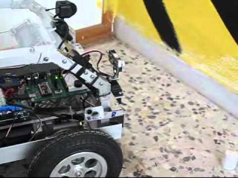

At this point I haven’t connected the position controllers yet. I run the robot without their help. I feel that I have a very big "BOE-BOT” with extremely power.
Here is the scematic and my first Bs2 Code.
You can also see a video of the rover here: http://www.youtube.com/watch?v=4OQ5ML0nngk
Feel free to ask me if you have any question.

  • NikosGNikosG Posts: 705
    edited 2011-02-14 16:03
    Hello all,
    If you like my rover here is an illustrative video of its construction:
    All the dimensions are given (I use cm units) and also all the steps of the construction.
    If you want to build a rover like this, and you have any question about, feel free to ask.
