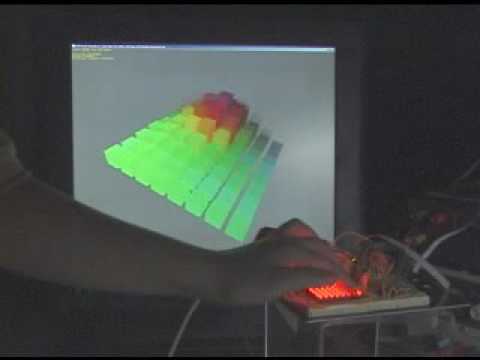

NOT MY VIDEO. Another forum linked to this amazing demo by Jeff Han on an old web page which is no longer maintained. I was blown away and thought it deserved a wider audience on Youtube, so I uploaded it there with a similar description. Still a WOW 10+ years later IMO.
Wow, indeed!!! I wondered if those AMOLED displays could use this technique instead of having separate capacitive touch hardware...

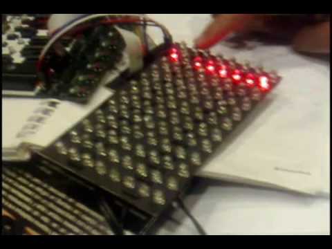

One of the requirements for led sensing, is that you have a light source that has the same wavelength for its emission as the wavelength for the led detector.
NOTE:
In this video demo, notice how the lights are OFF in the room.
This person is NOT detecting the light from the environment(ambient) to determine led state. (detect when the leds senses a lower light level, a.k.a. your finger blocking the light completely.
This demo shows sense of increased light due to the leds that surround it, the photons that are emitted from the leds surrounding the sense led bounce off the finger and into the leds currently in sense mode. (red works with finger because blood)
This means they didn't sense the entire array at once. And then emit light.
They did a sense sweep, like how a old crt tv drew its picture.
During this sense sweep, the other leds stay lit (through a pwm due to very low resistors, can't burn them long, low resistors for sensing[100 ohm])

The 8x8 board has multiplexed the leds anode and cathode with other leds in the array. This will affect your led sense, possibly to the point that it won't work.
I have made code that is able to sense leds in a multiplexed setup, but I only tried it where the anodes were all connected to a single pin.
I was still able to sense the led states with the anodes on the same pin.
But I think if you have the cathodes merged too, you will have problems.
CON _clkmode = XINPUT + PLL16X 'this chip gets its clock from the U2-PotReader prop. _xinfreq = 5_000_000 VAR blinkwait = 1_000_000 'time to wait to let led light stay on (CAUTION very high values will burn LED, and mess up program) readwait = 4_000_000 'time to wait to read for LED state change. 'do not uncomment these pin definitions, they are in the DAT section, this is only for reference. 'Led1 = 00 'Led2 = 01 'Led3 = 02 'Led4 = 03 'Led5 = 04 'Led6 = 05 'Led7 = 06 'Led8 = 07 'Led9 = 08 'Led10 = 09 'Led11 = 10 'Led12 = 11 'Led13 = 12 'Led14 = 13 'Led15 = 14 'Led16 = 15 'AnodeBase+ = 16 Anode of all 16 leds + 100 ohm resistor PUB LedMain | old, future dira[Base] := 1 'set direction of 1-16 leds anode leg. Repeat If old <> BpmStep 'only run if step has changed !outa[Green] 'toggle hearbeat led. ledstate16[old] := 0 'make sure led state for last step is now off. ReadLed(BpmStep, Base) 'read current step's LED for on state. LightLed(BpmStep, Base) 'light up current steps LED old := BpmStep 'store current step in old so we know we already ran for this step. PUB LightLed (n, p) '----bLINK led dira[n] := 1 ' make n pin an output outa[p] := 1 ' p - high LED ON outa[n] := 0 ' n - low LED ON waitcnt(blinkwait + cnt) 'wait for time to have led on. outa[p] := 0 ' p - low LED OFF dira[n] := 0 ' turn pin output off PUB ReadLed (n, p) '---READ led----- dira[n] := 1 ' make n pin an output outa[p] := 0 ' p - low 'reverse bias led outa[n] := 1 ' n - high 'reverse bias led dira[n] := 0 ' n - make n pin an input waitcnt(readwait + cnt) ' wait for pin to change state ledstate16[n] := ina[n] ' read state of n pin DAT Led byte 0, 1, 2, 3, 4, 5, 6, 7, 8, 9, 10, 11, 12, 13, 14, 15 Base byte 16 BpmStep byte 0'----------------------------------------------------------------------1 LedState16 byte 0, 0, 0, 0'-------------------------------------2-3-4-5-----------------4-5-6-7 byte 0, 0, 0, 0'-------------------------------------6-7-8-9-----------------8-9-10-11 byte 0, 0, 0, 0'-------------------------------------10-11-12-13-------------12-13-14-15 byte 0, 0, 0, 0'-------------------------------------14-15-16-17-------------16-17-18-19When multiplexing the Anodes, my code to read the leds dosen't change at all compared to reading a led with its anode not multiplexed.
Because your cathodes are multiplexed, they will cause some bleedoff. Also I think you have ULN driver chips on that 8x8 matrix, making the control of the led state even harder.
