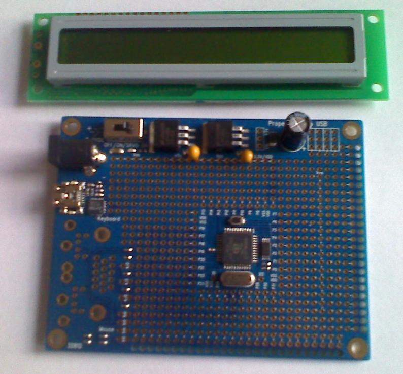

Every order requested so far has been shipped. So far I've sold 50 displays or 1/4 of what I have. Hopefully when Kimberly shows me how to sell on Ebay next Tuesday I can increase the price a little to ensure I get well over $100 to donate. Thanks everyone who ordered, I've had a good time learning how to take orders and run a business! Hopefully I can find something to sell a little more permanently in the future, I found a mission trip to a poor town in Mexico in March I want to go to
Here is my last attempt until I have some actual displays to work with.
This is a slightly modified version of the ObEx LCD driver 106, with a demo program. It should handle writing to the one-line display without the discontinuity at column 8.
Let me know if this works for you. If not, I'll have a working version next week sometime.

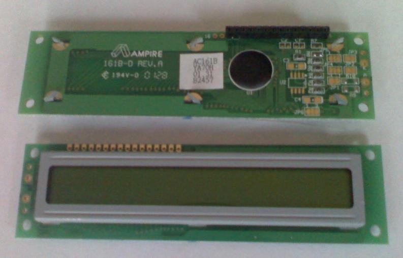

BTW, the display I just borrowed from a friend of mine is an old one, but it is a VFD (Vacuum Fluorescent Display) 4x20 chars that is HD44780 compatible (it is a Noritake CU20045SCPB-U1J), but it has a slightly different mapping from Display RAM addresses to screen character positions than most of the 4x20 displays around now. So I'll probably be putting together Yet Another Display driver object. More fun for this week.

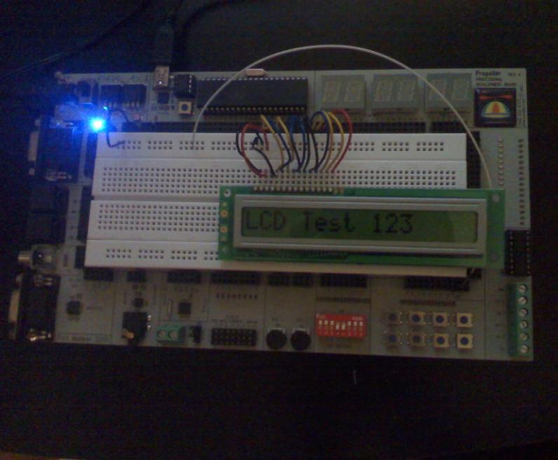

Trying to connect the LCD Display to Propeller Demo Board.
Running the file DEMO_LCD_16x1_4Bit.SPIN
Not getting anything on the display.
My connections:
Pin 1 of Display (VSS) = VSS on Demo Board
Pin 2 of Display (VDD) = 5V on Demo Board
Pin 4 of Display (RS) = P0 on Demo Board
Pin 5 of Display (R/W) = P1 on Demo Board
Pin 6 of Display (E) = P2 on Demo Board
Pin 14 of Display (DB7) = P4 on Demo Board
Pin 13 of Display (DB6) = P5 on Demo Board
Pin 12 of Display (DB5) = P6 on Demo Board
Pin 11 of Display (DB4) = P7 on Demo Board

I just received my displays today as well. But I will not have time to try them on the Demo board until Wednesday evening, at the earliest. But I will get it working, promise.
You might try a much simpler main test program, e.g.:

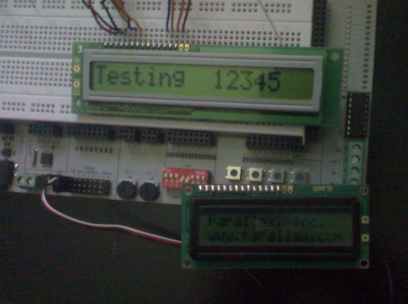

I "found" some time this morning to try out the new displays, rather than waiting until tomorrow night.
I too had trouble this morning, but the problem in my case was very simple: you need to connect the VO pin (pin 3 on the display board) to ground, or a voltage near ground. That pin controls the LCD display contrast, and a high level (or the pin disconnected) puts the display in minimum contrast mode, so none of the characters is visible.
Once I grounded that pin (maximum contrast), the display started working just fine.
OK, when I get home, I will try connecting the VO pin (pin 3 on the display board) to ground, or a voltage near ground.
ALso I don't have any current limiting resistors in series with the Propeller Pins. I don't think I need any?
I've been running it on 5v with no resistors and it's working just fine for me. I've noticed the power problem myself, with the display showing garbage if not powered down. I guess if you really wanted to the power could be connected to a transistor to restart the display.
Thanks very much for your help.
I used 1K resistors in line with the four data lines DB4..DB7, because I am running the display on 5V. That seemed to work fine.
The demo program works.
Only thing I noticed is that if I rerun the demo without powering off the demo board, I see garbage on the display.
Most of the time on the 3rd rerun the display looks corrects again.
Thanks Ding-Batty and pi'd, I am very happy to see one of the displays working :smilewinkgrin:.
