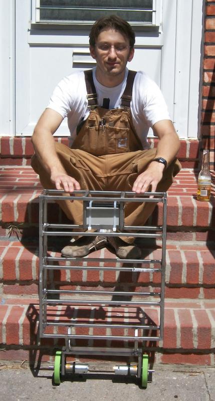

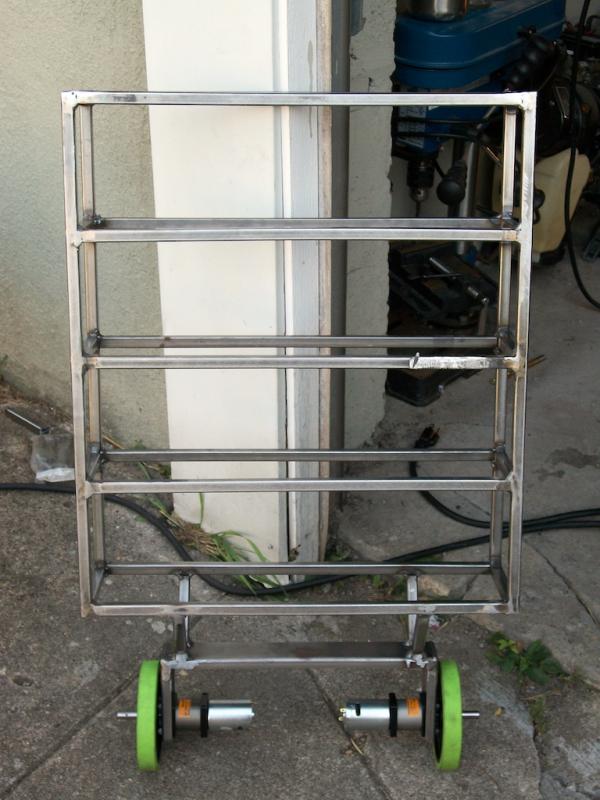

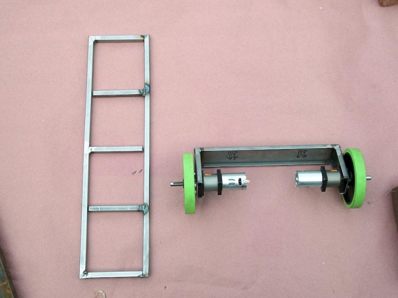

Here's a few photos of my first robot chassis. I wanted to make it out of Aluminum, but I don't have a TIG welder, just a MIG. So, I went to the store and found some 16 ga. 1/2" box section mild-steel tubing. I dont have a scale, the chassis isn't as heavy as you'd expect, but add the gearmotors and the 12 V, 7 amp-hour lead-acid battery and the thing is pretty massive.
Now, I'm going to ressurect the code from a faild balancing robot I made a couple years ago and adapt it to this chassis. My only worry is the signifigant backlash in the gearmotors. But on the plus side, I attached the battery directly to the motors and they are so torquey and fast it is able to recover from very signifigant tilt.
You can find more photos here.

    Good start, but your backlash will definitely come back to bite you in a balancing bot. Hard to compensate for that deadband in software, and mechanically, it will probably get worse in a hurry from all the extra overshoot & reversing. I'd recommend fixing that backlash first.
  • Jay KickliterJay Kickliter Posts: 446
    edited 2010-08-15 03:16
