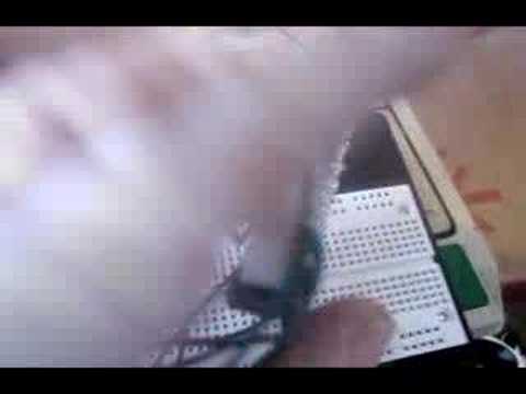

    This is the reason I asked that question. In my Elvinator Project testing the eye movements using the RCTIME and a VR with a 1uf cap this is part of the code I wrote for the test and it worked perfect. I had to charge the cap and then discharge it when the readings were caught. I see in the schematics that the cap is always charged buy the layout thus allowing the bot to go into a sleep mode with out drawing too much current. I'll have to try this option out when I can. Thanks for the link. and here is part of my code I was talking about and my video of it working.
    Main:
    GOSUB checkeyes
    IF RESULT =1 OR RESULT =0 THEN GOTO BUG ' if vr has no signal stop program
    IF result <= 1100 THEN GOTO EYELEFT
    IF result >= 2300 THEN GOTO eyeright
    GOTO eyeright
    GOTO MAIN
    BUG:
    DEBUG "bug found in VR READINGS = ", DEC RESULT,CR ' if signal loss stop routine
    STOP
    checkeyes: ' checking the VR location
    HIGH 7 'use pin 7 to Discharge the cap circuit
    PAUSE 1 'for 1 ms.
    RCTIME 7, 1, Result 'Measure RC charge time. convert analog to digital
    LOW 7 ' Recharge the cap for next round
    RETURN
