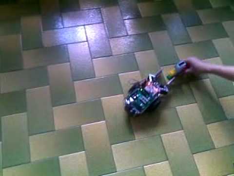

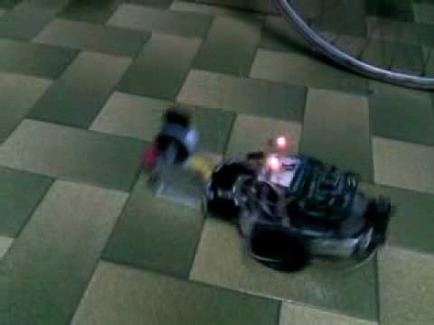

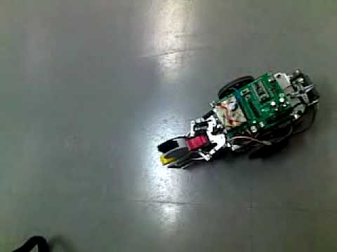

  • CJWCJW Posts: 77
    edited 2010-05-08 10:13
    Hi Mike,
    I have use the program but i do not know why cannot grip on it in the first round. This is the link hat I record
    Is it I need bring the IR to put on top of the gripper. Below is my program. Thank you
    Yours Sincerely
    James

  • CJWCJW Posts: 77
    edited 2010-05-09 09:19
    Hi,
    I have troubleshoot but it didn't turn well. I really need help to guide me until the end. This is the link that i recorded , I also have attachment for the programming.Please help me I only left 1 more week to go or else I will fail this module as I still got another want to troubleshoot. Thank you.
    Yours Sincerely
    James

  • CJWCJW Posts: 77
    edited 2010-05-09 15:35
    Hi Mike,
    What do you suggest as I want the bot to
    1) turn round as when the bot detect the item, the bot will go forward and grip the item.
    2) When the bot grip on it he will reverse back and either turn right or left to drop the item
    3) repeat the same thing again.
    As I posted the video and attach the program is not able to do that. Please help me,
    Yours Sincerely
    James

  • CJWCJW Posts: 77
    edited 2010-05-10 04:36
    Hi Mike,
    I try some error but when I on the bot. It will automatic close the gripper, when it sense something the led will high and the gripper will open.
    Yours Sincerely,

  • CJWCJW Posts: 77
    edited 2010-05-10 14:22
    Thank you.. I will try the error again..

  • CJWCJW Posts: 77
    edited 2010-05-10 16:12
    Hi Mike,
    I have try some error until i got this but i don't know where to change the bot stop turning when it grip on it. Can i i use this to do following a stripe line. Above is my attachment and this is the link i have recorded
    Sorry for all the trouble, but I would to say thank you for helping me. I hope I have improve a lot.
    Yours Sincerely
    James

  • CJWCJW Posts: 77
    edited 2010-05-12 12:28
    Hi,
    I still trying to troubleshoot but i still get the same thing that I have post up. I still cannot find the mistake. Can I know counter = 100, is for usage? Can anyone assist me, please. Thank you
    Yours Sincerely
