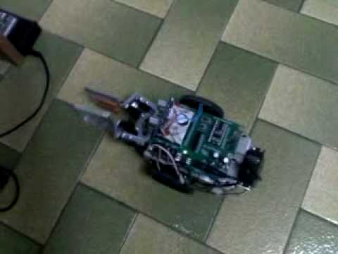

Hi,
Below is the Roaming with Ping programming. I would like to know the coding detail. For example: is there any resistor I need to put or wire. This is the link for the video " As I can't make it go forward and so on. The components I use navigating with infrared headlights.
Yours Sincerely
James

- Stephen
Based on the video link, you might have to remove the gripper to mount the PING bracket. As far as resistors and wires- It would take the same connections as mounting directly onto the breadboard- the kit has a 10 extension cable for that.
It looked like you have the PING setup on the front of your BOE-BOT, but I didn't see any IR emitters or receivers; what are you using to navigate? The code you posted needs both the PING and IR to work properly.
Basically it looks like your code and current configuration are incompatible.
