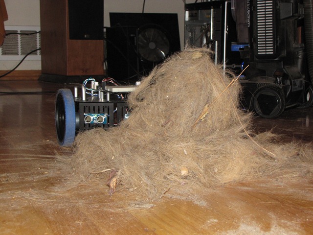

...30 minutes later I figure out enough of gimp to reduce one of the pictures small enough to meet the upload restrictions :-) Amazing how tangents can keep you off task. I have the detail of the servos, ping and camera but I hear my dinner calling and don't know how to easily / quickly reduce the size of the other picture... utility or suggestions or FAQ to RTFM welcome.
Note my handsome dog Sampson with a Stingray robot above him showing the x/y servo mounting, a ping sensor and above that a uCamTTL from http://www.4dsystems.com.au/prod.php?id=75

I had just finished a C# class, and had installed an x/y tilting and rotating set of servos on my Stingray. That combined with a recent purchase of a few xbee radios I came up with the project to apply some of the C# and reacquaint myself with .spin
I've gotta get that Stingray doing something other than jousting dust bunnies. (for a laugh see: http://www.rodaw.com/wp-content/uploads/2010/01/IMG_0355.jpg)
