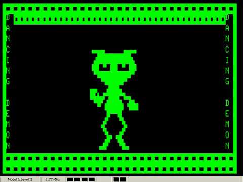

I want to emulate the TRS80 on the DracBlade. What I would need was a TV and/or VGA driver capable of 64x16 characters using a 6x12 pixel chargen. I saw that Cluso99's Debug_1pinTV does 64x25, so 64x16 should be possible as well. It wouldn't need any terminal code, as the video RAM is at a fixed address and would be modified by the Z80 only. The question is: will it be possible to fit 128 characters with 12 bytes each? If not, the chargen could be restricted to 6x8 pixels (as the real ROM was) and there would be no descents on g,p,q and y (the unmodified TRS80 didn't have them either).
The second thing is probably more complicated, or perhaps not. The 2nd 128 characters are block graphics with a 2x3 raster. That means a pseudo pixel graphics of 64x2=128 by 16x3=48 pixels. I guess these graphics could be derived from the code on the fly somehow, but I don't know if there's enough time to do it in the active phase. It probably needs some longs with none,left,right,both pixel set that would be indexed by the character code and scan row.
The bits are 0:top, left 1:top, right, 2: middle, left, 3:middle right, 4:bottom left, 5:bottom right. Bit #6 is irrelevant, i.e. the block graphics is repeated once.
Is it hopeless to believe this is doable, or does it perhaps require a 2 cog solution with separate scanline renderer and scanline emitter?

TRS80: My 1-pinTV can do 64x16 (needs a parameter change or just leave the top/bottom 2 lines blank). 64 columns will work at 96MHz (6MHz xtal) or at 80MHz if you remove inverse video. My driver is text only. The screen buffer is not setup as a pixel buffer. If you are not using graphics, then just use the 8x8 font. You will not fit a 6x12 font or a 6x8 font in the driver. The x12 will not fit because of size (needs ano 512 bytes in cog!). The 6x will not work because of speed unless you remove the inverse video.
For the graphics: If you used 12K of screen buffer in hub and held it as pixels you could do it. Alternatively, you probably could use 2 cogs to do it. Potatohead may have some tricks.

TRS80: The characters are in the upper 8 of the 12 scanrows IIRC. Inverse video isn't needed, but the block graphics, which is most probably worse than inverse. Wasting 12K screen buffer is certainly too much, so I think I should try a 2 cog solution with a bitmap scanline renderer, or perhaps 2 bitmap scanlines to be one line ahead with the rendering cog. I think the bitmap video could be the simplest of all, as there is no indexing, but just sequentially shifting out the bitmap data.

I'm putting the things together now: SD support for reading the TRS80.ROM file from any FAT. Video cog and renderer cog for the TRS80 graphics. Modified read/write handlers that protect ROM against overwriting and detect writes to the screen buffer. Doesn't run yet.. tough.

That will be difficult without cycle counting, because you won't get a stable picture I fear. I can implement interrupts by exporting a long that would be read at every instruction and would then allow to do either NMI or IRQ depending on 2 bits. Of course this would be optionally, because it certainly slows down the emulation.

The TRS80 clock interrupt and FDC interrupt, sharing the same one IRQ (RST 38 vector). The clock was 40Hz if I'm not totally wrong. Memory mapped IRQ status register at $37EF with one bit for the clock, and one bit for the FDC. I will try to emulate the Model I with Level 3 Basic (12K) and probably without the FDC, because emulating that one is a lot of work. It should suffice to shuffle a cassette image into main memory and tweak a vector or two to make the programs go. No interrupts necessary for this setup.
It will need a prop with SD card and external memory, so any of the Blades should work. Sound is something I did not yet look into. It needs a 3 level DAC.

Spectrum version is a bitmap anyway, and we already have drivers for that [noparse]:D[/noparse]
http://www.propgfx.co.uk/forum/·home of the PropGFX Lite
http://ganley.org/software/trs80.html
http://www.tim-mann.org/trs80faq.html
http://www.vavasour.ca/jeff/trs80.html
Once it is done perhaps you can run this....
I've written a few myself. No, really [noparse]:)[/noparse] The first one I wrote was on an AT286 4.77/10MHz and written in x86 assembler...
He died at the console of hunger and thirst.
Next day he was buried. Face down, nine edge first.
