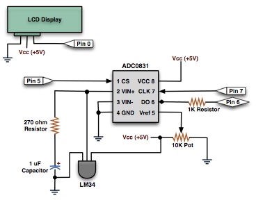

Well here it is my first real completed Propeller project that actually does something useful
. I have been working with the Propeller demo board for a few months now, learning spin and playing with sensors, but I actually put more effort into this one to make it useful to share. Others may find a trick or two and learn something as well. All the code is commented and I drew a proper schematic diagram for the project. When I get done building and playing with my Penguin kit, I may add the Parallax Humidity sensor and/or the Pressure sensor to this project. Then I will have the start of a nice little weather station. If anybody takes this project and beats me to it I would love to see what you have done with it.

Here is a small picture of the schematic used (I started with one I borrowed from a project by Larry Freeze):
Once you have built the circuit and loaded the spin code into the Propeller to run it, all that's left is to calibrate it. I used a regular small glass (made of glass not plastic or ceramic) filled with ice which I placed as close to the LM34 as possible. Actually touching it would be ideal. After a minute or so to let the temperature of the glass lower the temperature of the LM34, I turned the 10K pot until the display read about 33. Yes I know water freezes at about 32 degrees, but this depends on what altitude you are at and the air in the room will heat the exposed part of the LM34 a little. If you know a better way (short of using an actual thermometer, which all I could find were digital ones meant for using on people) feel free to share it.

There is another way to calibrate the readings as the output voltage is linear to the temperature and the internal calibration of the LM34 or -35 is already done by the factory. Use a digital multimeter to measure the voltage output on the LM and then adjust the Pot until your display shows the same as your multimeter.
A really do enjoy to read about useful projects!
Hey, thanks for the tip, I thought it might work that was after reading the data sheet for the two product but I wasn't sure.
Now you see I post this project for others to learn from and lo and behold I am the first one that learns something!
Thanks, I will try it!
