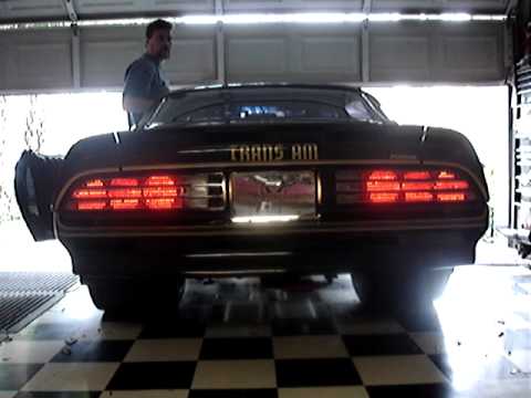

    Ok Looking at your other post I know see what you want to do. You want the lights to sequence when they come on. I've attached a drawing that explains one way to hook your trailer plug to the prop. This by no means is a complete circuit because you will need to supply a constant power to the prop and you'll need some hardware to go between the prop and your LEDs
    As far as how to have it tell the difference between whether your braking or turning that will be a little harder and personally I wouldn't worry about it. I would let it sequence every time power is applied and just make sure it happens before the light would turn off and back on. That way if your just applying the brake it sequence and as long as the input to the prop stays high it will stay on fully. But if the pin cycles high to low then back high it would restart the sequence.

    I just re-read the original post and I THINK what you are trying to do is a sequential turn signal. You should re-write the original post so it is a little more readable. It is very hard to understand what you are trying to accomplish.

    Here is one more example of what I am looking for..........I found it on YouTube
    But I only what the Propeller chip to run the right side of the car..............
    Brake and right turn light..........
