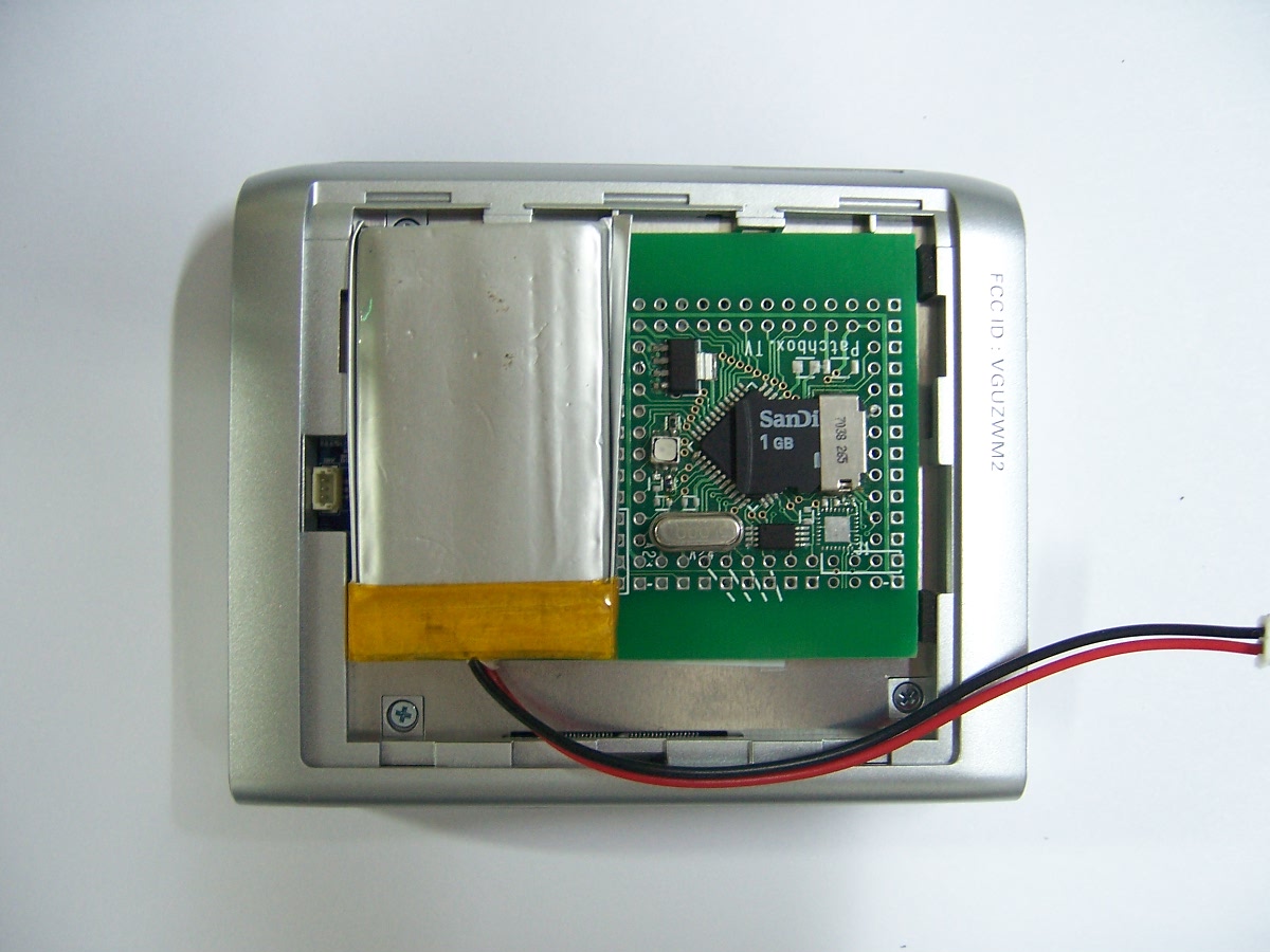

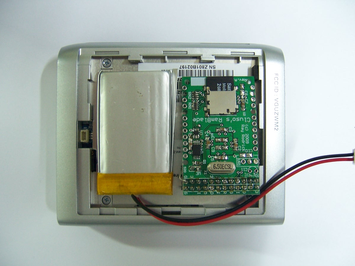

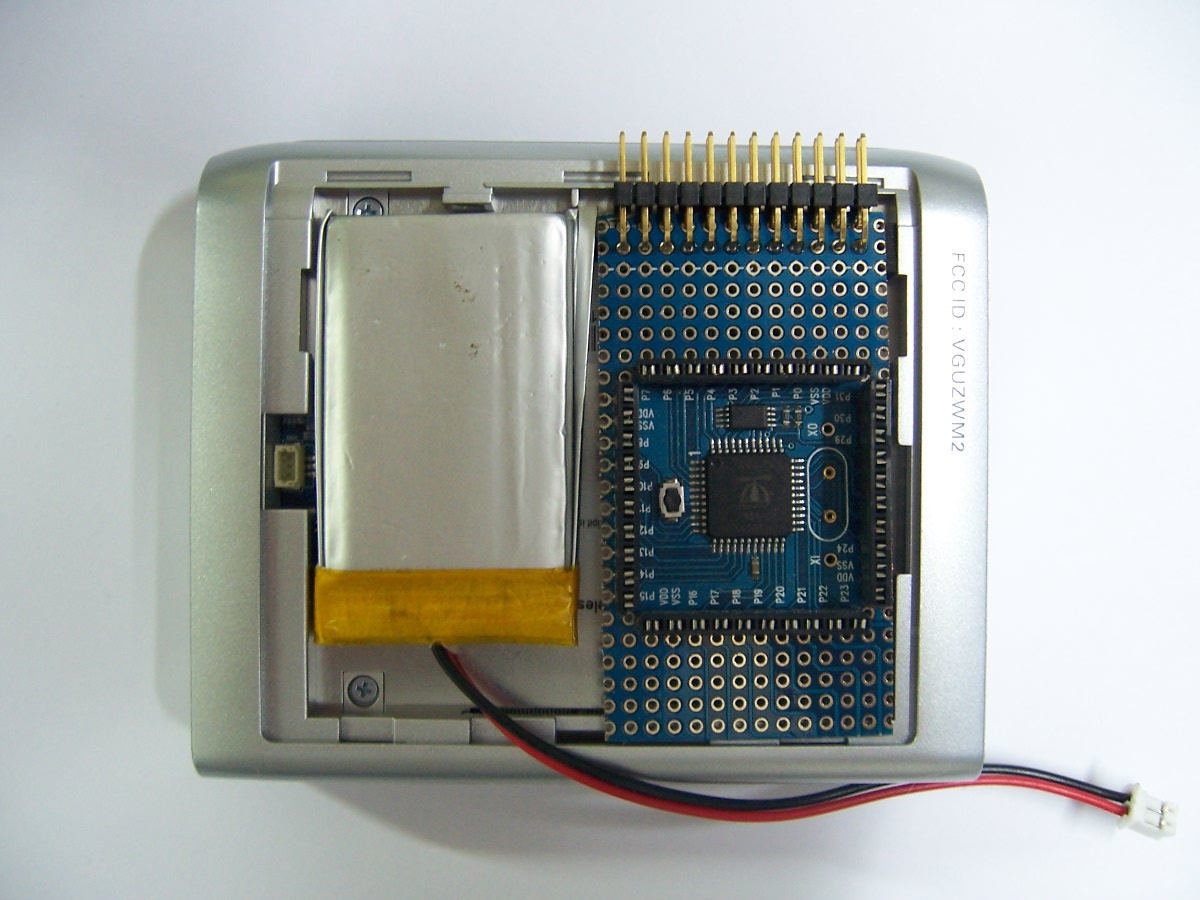

    Just playing around with some possible formats, trading battery space for 8 cogs seems a good trade to me. All options would need a lower profile crystal.
    The other possibilities are to connect the prop inside the Hirose backshell (waiting on connectors), or even via the MiniSD port (it would project at least 12mm)
    1200 x 900 - 226K
    1200 x 900 - 240K
    1200 x 900 - 259K

    There doesn't seem enough room throughout the bottom to replace that whole metal plate with a circuit board, but there is a space next the the speaker that has little population.
    I would like to use my Zipit battery to get longer run times.
    Now that Patchbox is a cute little board. Did I miss the announcement somewhere?
    Post Edited (hinv) : 3/7/2010 3:23:50 PM GMT

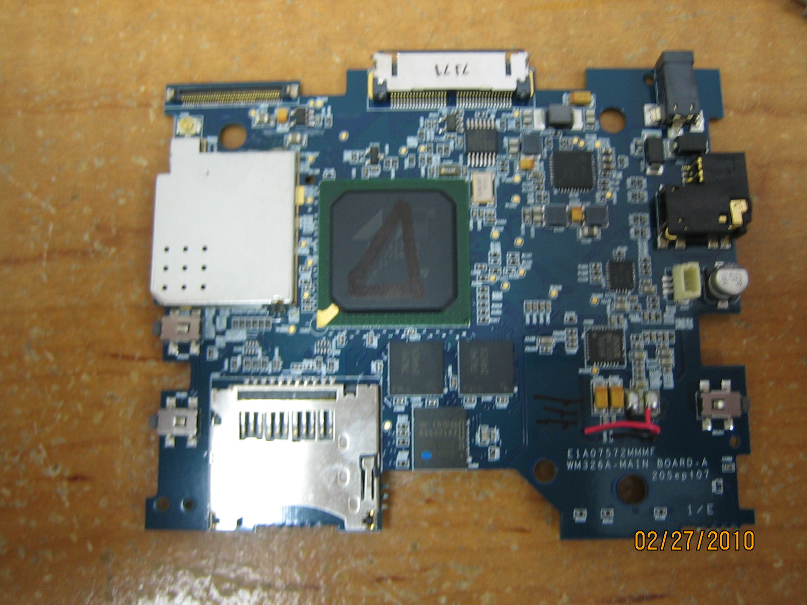

    I was thinking of running of the oscillator that is built into the Zipit. Supposedly, it is 13Mhz, but unfortunately, my 50MHz Scopemeter doesn't show a clean sine wave so I can measure it.
    But what I wanted to know is. Is that little rectangular thing NorthWest of the ARM cpu a crystal or a crystal clock oscilator. From what I can tell, it appears to be just a crystal.
    If so, I probably couldn't tap off of it right?
  • TubularTubular Posts: 4,740
    edited 2010-03-07 20:35
    hinv said...
    Thanks hinv. Its my contribution to the ancient art of matchido, or stuffing propellers into matchboxes. I did post something back in 2008, see Patchbox.Tv.
    I guess that rev3 in the photo never really got announced because I haven't tested the qfn FT232R (lower right in photo) yet. There's rev4 coming to soak up some of that wasted space up at top right...

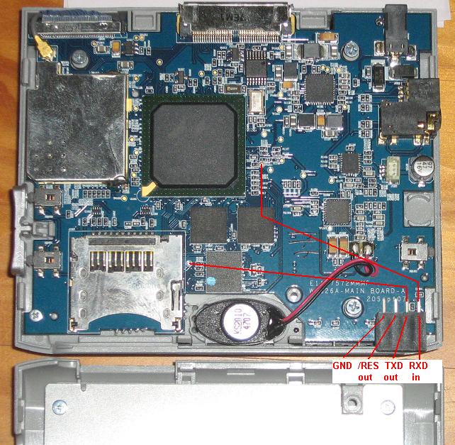

    What's anyone's progress with the Zipit and Propeller?
    After having mine sitting around for long time I finally got mad and chopped off the Yanki wallwart and connected the remaining cable to a 5v outlet from my PC and charged it up.
    Well fine it started up into it's out of the box software. However very soon I managed to get Debian Linux installed on it by following the instructions from here: mythopoeic.org/zipit-on-linux-debian/
    Beware: You will need some slightly newer *.deb packages than the ones linked to from there. Things have moved on a bit already. In fact I still don't have the wireless wpasupplicant package installed as it depends on a few other things now. But WEP or open wireless should work as is.
    Well blimey, this thing runs Debian from the command line and you can start X Windows on it!
    I've been having a bit of a laugh getting our embedded projects from work running on it.
    Next up I need to get the soldering iron out and get the serial port working, then sort out the WPA wireless installation. At that point we have a terminal for the Propeller and the Prop on the internet.

    Finally managed to get secure wireless networking on the Zipit up and running using WPA.
    This means I can now use secure shell (SSH) to login in to my Zipit from a PC over the air.
    I have been following Douglas G. Henke's instructions here mythopoeic.org/zipit-on-linux-debian/. Douglas has been updating and expanding on those instructions as I go along and report problems.
    Next step is the Propeller connection. There is a description of connecting some wires to the Zipit PCB for it's serial port here http://elinux.org/Zipit_Serial_Mod. Looks a bit tricky.
    I'm hoping to be able to connect directly to the Propeller (No MAX233A circuit). Any anyone confirm if that's wise or not?
    Battery life of the Zipit has only been one hour or so. Looks like I could quite happily discard the battery and put some Prop circuitry in the battery bay.

    The stuff on that page intimates the Zipit is 3.3v anyway, so put a couple of series resistors in and go for it.
    If you can get a gpio to toggle and have the serial lines then we have the basis for a propeller loader.

    I'll do that.
    That thing has 120 so called GPIO pins. Some how have to find one that is not doing some other dedicated function and hope it comes out somewhere accessible.
  • heaterheater Posts: 3,370
    edited 2010-05-27 06:12
    According to this page www.gumstix.net/wiki/index.php?title=GPIO it is quite possible to configure (in/out) and then read/write GPIO pins from user space programs in Linux on the gumstix boards which use the same PAX270 ARM processor as the Zipit.
    I notice that the Zipit Debian I'm running does indeed have the sysfs files in place: /sys/class/gpio/ etc etc.
    So if we could find some spare GPIO and where they come out we can test them even from scripts.
    Anyone had any luck finding them. As far as I can tell there is a camera interface coming out to the rear connector which is unused. How to connect to it?
    With just one GPIO and the serial port connections we can get the Zipit loading Propellers.

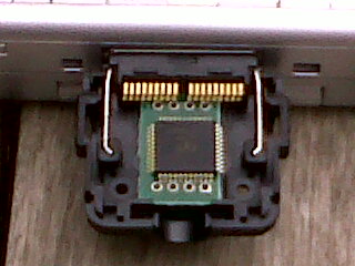

    Farnell/Newark sell the connector that goes into that expansion port. I ordered a couple.. that might be the cleanest way to start

    Heater, this is the connector link thanks to bobdole369. I can post some detailed photos later if you like

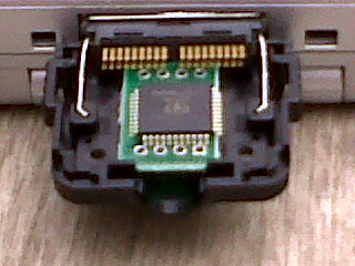

    Photos, yes please. That connector is so tiny I wonder how we ever connect anything to it.
    edited 2010-05-29 03:42
    Heater,
    I have to apologise for the quality of these photos, I'll try and get some better ones later.
    The connector has two rows of pins, which look like they would straddle either side of a 1.2mm PCB. There's not a whole lot of room in there, but it should be possible to fit a prop, xtal and eeprom and some pads for i/o via cable
    There is some optional shielding steel which I haven't shown
    320 x 240 - 20K
    320 x 240 - 23K

    Great. Hadn't occurred to me that one could fit a Prop in the connector housing like that. I like it.
    Sadly the serial port does not come out on that connector. Perhaps we could make a Prop loader by bit banging the GPIO pins that are supposed to be the camera interface or some other.

    As you probably read here I have Debian running on my Zipit quite happily with X, like you I'm happy to use text mode only, WIFI works so I can SSH into the Zipit.
    Next step, among all my other projects will be to get a serial link out to the Prop.
    What would be great is just a single GPIO line to use as reset for the Prop. Then we could get a Prop loader running on the Zipit.
    Of course having USB OTG/HOST would mean we could run a USB-Serial adapter to the Prop and load it that way. I look forward to any news about that.

    Now that clockloop showed us tht you can piggy back several props XI on the XO of the crystal connection of another prrop, it should be doable to clock the prop from one of the lines on the 13MHz crystal in the zipit.
    I have a prop connected to almost all of the testpoints on the zipit board, but I don't know where to start to wiggle the gpio pins on the ports. It is a bit over my head at this point. I wish the Z2 was a bit more open hardware wise.

    Hinv: "I have a prop connected to almost all of the test points on the zipit board,"
    In that case you probably have the test points for the serial connection already connected and can start talking to your Zipit via FullDuplexSerial or whatever.
    Somewhere on the net I found a nice description of the required serial port test points and some very clear photos of exactly where they are on the board. Can't find it just now but I have it bookmarked on the computer in my office, I'll post a link when I get back to work.
    How many other test points are there?
    As for the other GPIO's we need:
    1) To know the processor type.
    2) Get a data sheet for it.
    3) Find the addresses of the registers driving GPIO pins (May be shared with USB or whatever.
    4) Get access to that memory range from a user space program.
    5) Start trying to write ones and zeros to those addresses.
    Fortunately, we don't need a Linux device driver for 4). We can make a little 50 line program that can get us access to all of physical memory from user space when running as root. DANGEROUS!
    Then for 5) create a test script that uses the memory access program to try and wiggle what we think are the GPIO port addresses. Perhaps start with the serial out pin as we know where that is on the board.
    When this is busy not crashing the Zipit one might get lucky and the Prop will detect a signal. BINGO we are in.
    edited 2010-08-04 05:40
    hinv: Do you have a Debian installed on your Zipit?
    Do read about tweaking GPIOs from the command line here: www.gumstix.net/wiki/index.php?title=GPIO#Accessing_GPIO.27s_from_userland
