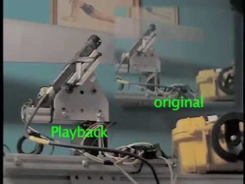

I want to build a 2 axis pan&tilt head for a videocamera.
I have seen tons of hobby-servo pan&tilt units but i´m looking for something more accurate that can stop and start moving smoothly. I know that it can be done with dc motors and a joystick or any other potentiometers, but what really interest me is to record and playback the motor acceleration and position for repetitions and playback of stored moves with precision.

The control board used for the video is a professional and expensive Kuper Control board driving 2 stepper-motors powered and controlled by 2 gecko drives (common drivers for CNC machines).

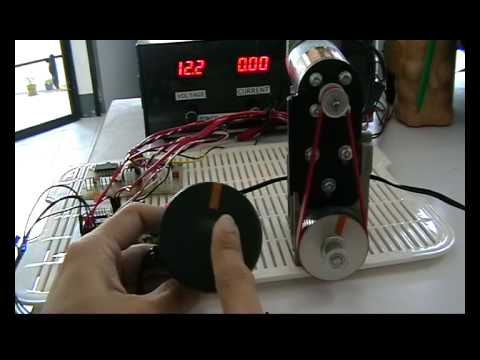

I manage to make Dc servo motor to turn with an Incremental encoder, but haven't figured out the playback bit.
http://www.youtube.com/watch?v=U-mwTGZAcr4
Freddy
