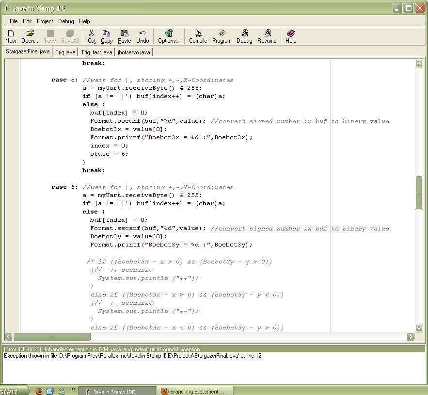

Hi Peter, May i know how to solve IndexOutOfBoundException? I need to use a calculation to determine if the result satisfy an equation as shown in case6
--> if (mulr + muly - mulr <= 0).
mulr, muly and mulr is a mulitplication of itself. I realise that if there is multiplication IndexOutOfBoundException will occur. I tried without multiplication and the codes can run fine.
finx = Boebot3x - x;
mulx = finx*finx;
finy = Boebot3y - y;
muly = finy*finy;
mulr = r*r;
I had read through the manual, is it due to Javelin being unable to perform Garbage collection. However, i need to perform the check using the equation.

So it must be that either buf[noparse]/noparse or value[noparse]/noparse·is too small.
It cannot be value[noparse]/noparse because that only needs to store one integer.
Increase the size of buf, eg. buf[noparse][[/noparse]256]
That should be large enough to hold at least 4 messages.
regards peter
