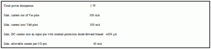

    STOP IMMEDIATELY: you have still the 300mA max current limit on the power supply lines. You can sink up to max 40 mA per IO but the total current consumption (including the prop own) should not exceed the 300mA limit.
    Some considerations can apply here:
    [img]http://forums.parallax.com/attachment.php?attachmentid=73935[/img]
    • From current consumption graph (datasheet V1.2 Ch.9.1) we now that @80MHz 8 cogs running spin (so accessing hub - most of the hardware powered) consume 80mA. Still 220 mA are available to both the Vss and Vdd
    • Now the only current flowing into vdd and out from vss at the same time is the prop internal current consumption. When the output sink current it is flowing into the output and out from Vss, when output source current it is flowing into Vdd and out from the output
    • Does it means that·we can have at the same time 11 outputs sinking 20mA and 11 outputs sourcing 20mA ??? So 20mA on 22 outputs?
    Answer: YES. You must pay attention on how you distribute the current arround the IOs and understand the difference between sink (eg. P1 led wired to vcc - ON on 0) and source (eg. P2 led wired to gnd - ON on 1)
    · Propeller Object Exchange (last Publications / Updates);·· Vaati's custom search
