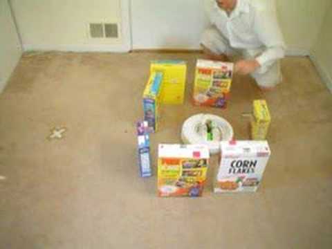

    The robot should be able to map a certain room lets say for example 5x5 squares it would start at a certain position in the grid and finish at another grid position. The robot can update its map when objects get in the way. Its not just reactive wandering, but planned navigation. This isnt pure reactive mapping:
    it knows where it is
    it knows where it has been
    it knows where it is going
    it knows the locations of moving obstacles
    it optimizes for minimal travel distance
    and it cannot be tricked! Its adaptive!
    One way do to this is to implement the wavefront algorithm.

    It would be difficult (bordering on impossible) to do this with the stock BOE-BOT chassis. At the very least, you'll need some encoders so you can tell where you are and some sort place to store the acquired map (EEPROM is too small). A datalogger, external EEPROM, or wireless link to a computer would all be reasonable choices. Once you get that far, seriously consider upgrading the processing power. You can go to a faster BS2 (okay) or a Propeller (better). The next step would be to upgrade your sensor array with some sort of distance detector: either IR or ultrasonic.
    Edit: I just watched the video. I think that although he may have had the robot create a map, it isn't necessary to solve that problem in the exact same manner. Basically, the same thing can be had for three "local" objects that represent what the robot sees left, right, and forward. Combine that with two cartesian points of the robot's position and the destination, and you get the same result.
