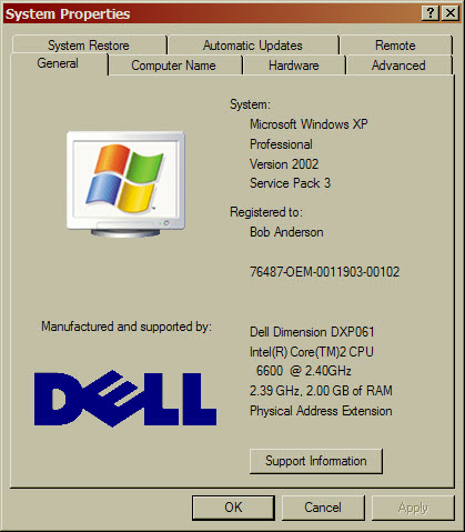

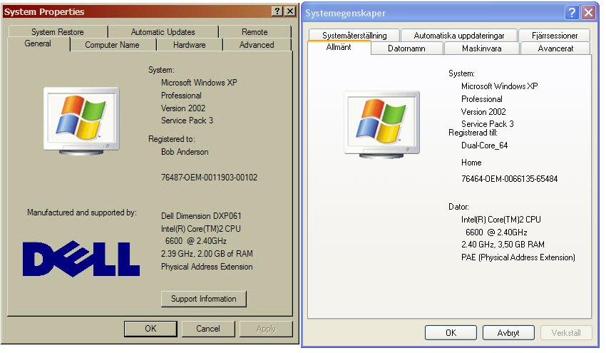

  • Bob AndersonBob Anderson Posts: 122
    edited 2009-10-31 15:32
    I use Visual Studio 2008 C#. I have told it to compile for "any processor" and use .NET 2.0
    Is your processor 64 bit?
  • SapiehaSapieha Posts: 2,964
    edited 2009-10-31 15:35
    Hi Bob Anderson.
    I have Intel E6600 DualCore procesor 2.4GHz.
    XP is 32 bit's version
    Ps..· My Win is international Swedish char set

    I still don't see where there is a difference that might explain your difficulties.·
    I did a build of AAC that is a 32 bit build.· I have attached the exe part only to this post.· It will be looking for the manual (.chm) in the same directory that you put this file in.
    edited 2009-10-31 15:55
    Sapieha:
    Sounds like we have identical systems except for character set.· I have no experience with that.· Could you temporarily change that?
    My Win XP Pro is 2002· SP 3

    Hi Bob Anderson.
    File "AACclient.exe" are only 68KB it can't be posible it is stand alone.
    It must load old blocks from previous installation
    My XP comp are near same as Yours

    Size is correct. Thats .NET Framework 2.0 doing its thing. I have loaded that file on a little laptop and it runs fine, except with no manual.
    The laptop never had AACclient loaded in any form.
    But did the new build help you at all ???
    edited 2009-10-31 16:26
    Hi Bob Anderson
    Sorry .... But ... NOT
