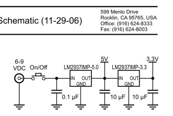

    @fisio - The diode is not needed because the voltage regulator used is designed to withstand reverse polarity power connections without damage to itself or the equipment suppled by it.

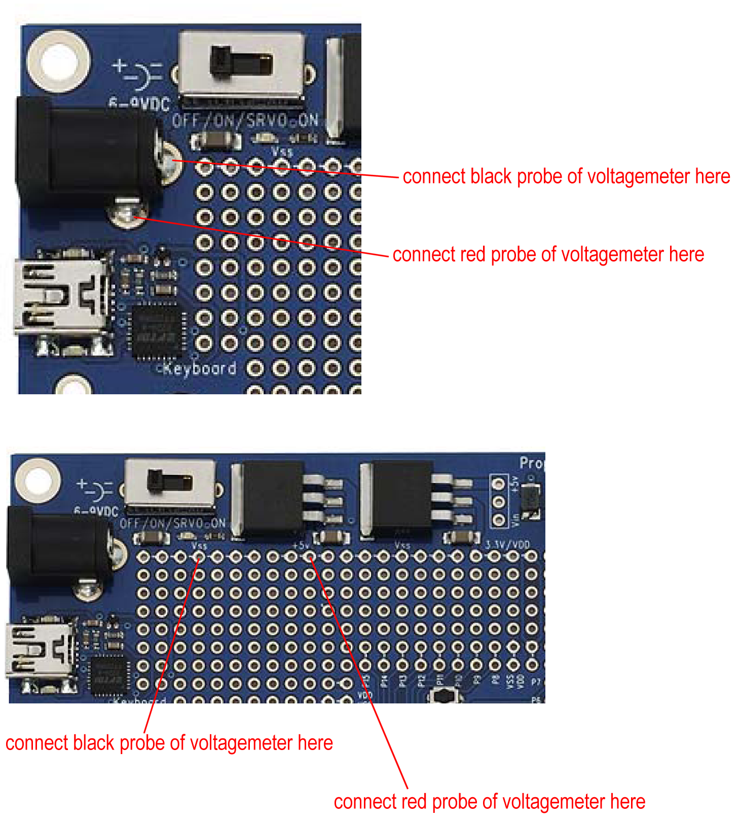

    yes a comment,
    do we all have chrystal balls to look inside what you did wrong ??? NO !!
    to state the obvious things:
    did you check for the right polarity ?
    did you check for "cold solderings" (beeping through the wires)
    did you check the voltage of the battery when it is connected to your protoboard ?
    maybe the voltage brakes down if it is connected to the protoboard
    did you check the current flowing from the battery to the protoboard when connected ?
    If it REALLY has 7V it is 1V MORE than the schematic says so it should work (6V-9V)
