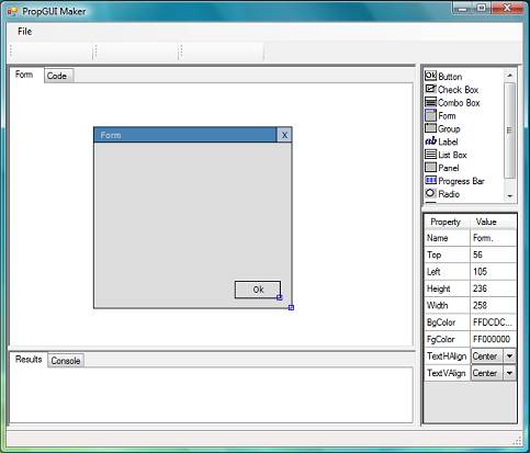

    A reasonable alternative which I have investigated would use wxFormBuilder generated XML to create Propeller sized widgets.
    The problem is having a strategy for creating all the widget code that anyone could follow. I have a minimal set with TextBox, ListBox, Label, CheckBox, etc ... for specific devices, but they need to be generalized. Also the current set of TV/VGA drivers that are capable of color/shading per pixel, etc... do not offer high enough resolution, so that puts a TV like GUI out of range.
    edited 2009-10-16 20:54
    Adam,
    At the very least, you would need essentially a GUI compiler that would take in either something like XML or a special purpose GUI language and generate some very compact tables and select out the methods that might be needed from a library of methods. This would result in an object that could be included in your program. As jazzed mentioned, even a minimal XML parser would take up too much memory. Given that the Propeller Tool doesn't do elimination of unused methods (within a object), you really need something external to pick and choose the set of methods needed to implement what you want for a GUI.
  • jazzedjazzed Posts: 11,803
    edited 2009-10-16 21:42
    I guess I didn't make it clear that I started writing a GUI compiler in my "investigations" [noparse]:)[/noparse] I also wrote a GUI maker front end which is mostly functional, but decided using a tool like wxFormBuilder (which is cross-platform) might be easier for the user and the developer to a point.
    TinyXML looks like a reasonable parser for adding to the "compiler" ... matching the names and applying the properties to code could be very easy using widget templates.
    A video that demonstrates some of the widgets possible is available here: www.youtube.com/watch?v=YalcMqkdHEU
    Here's a picture of my PropGuiMaker:

    Maybe so if the underlying driver were easily replaced ... it ain't Graphics.spin and never will be [noparse]:)[/noparse]
    The PropGuiMaker application that could be used to simplify creating such GUIs has been lying
    around in my computer unfinished and may be public some day in one or more incarnations.
    One thing that stops me from going further with the PropGuiMaker is having a good Propeller
    VGA/TV driver that makes similar quality Propeller video possible. I'm working on this [noparse]:)[/noparse] ...
    but I have no idea whether a GUI like in the video can be done with one Propeller or even two.
    The display in the video is the Nokia-Knockoff I2C LCD that has built-in memory. I do have the
    Parallax OLED128 that I plan to use if possible. Other LCDs with on board memory could be
    easily adapted. If there is sufficient interest in the LCD only, I could just work on the GUI maker.
