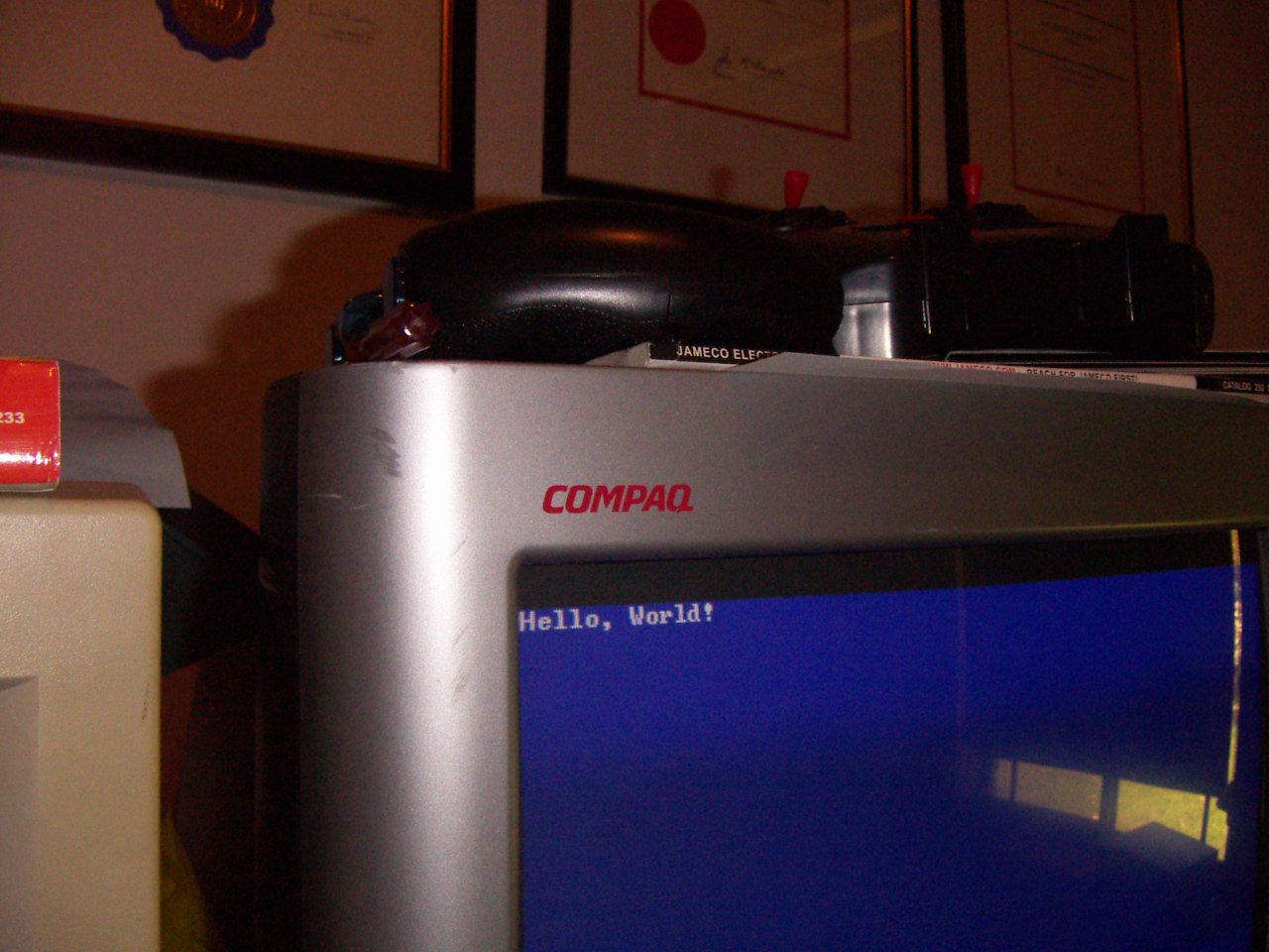

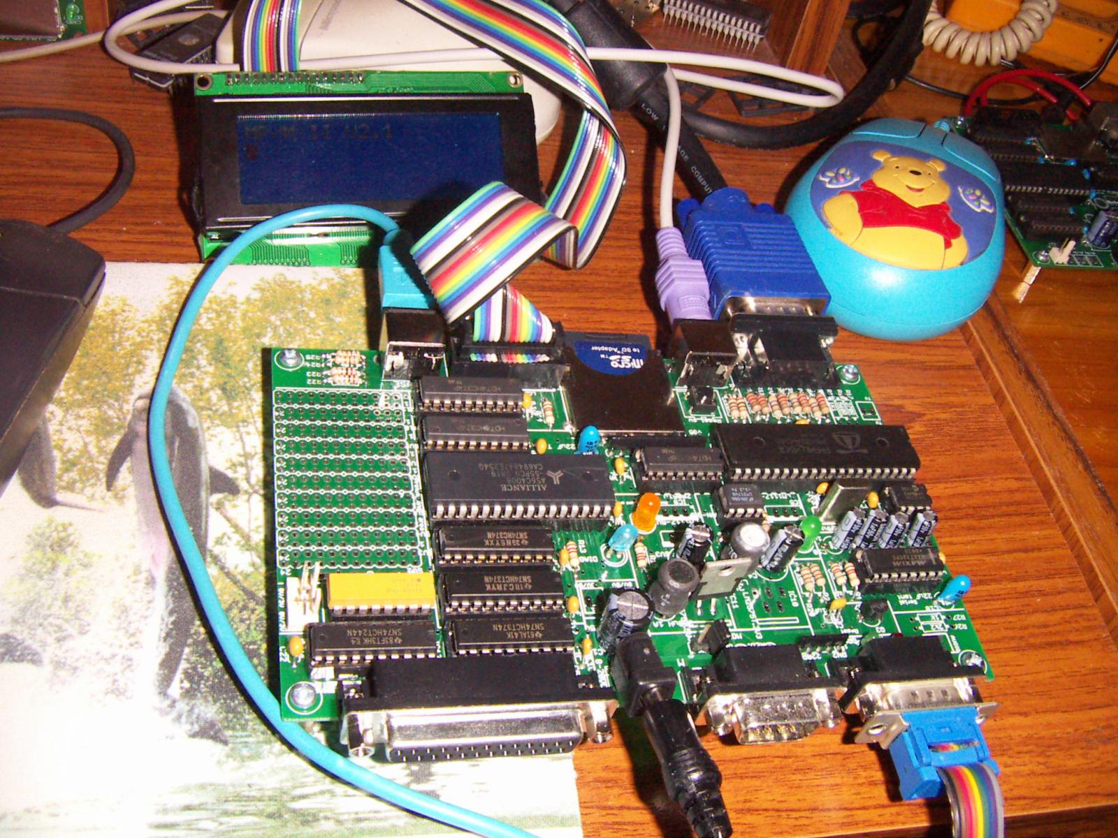

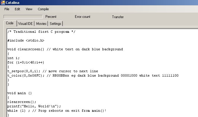

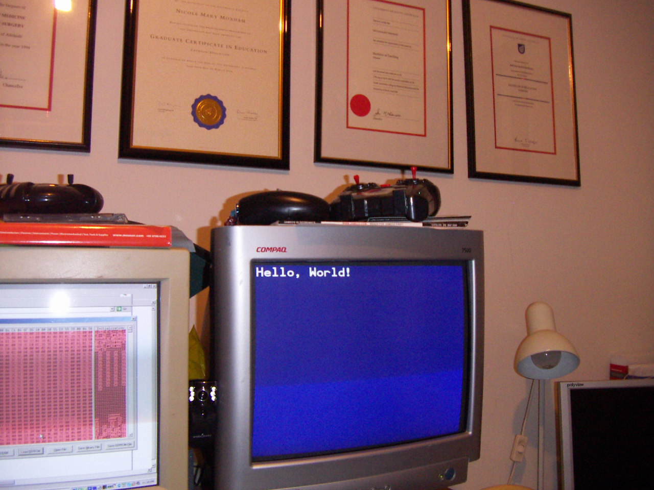

    Ok back in the saddle. I got version 2.3
    The first one is the same as before - flashing cursor, green background and no text

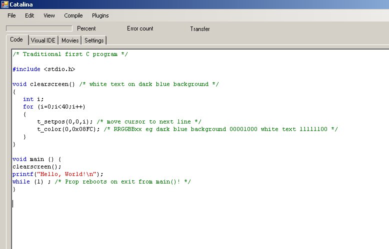

    I tried simplifying the one that works with the second option and just changed the hires vga to low res VGA and that works fine.
    So I think the problem is with linking to the hi res vga driver (or the driver itself).
    The program doesn't test the keyboard as such, but the keyboard lights are blinking on restart, so I think the keyboard is working ok too.
    I've taken a working Dracblade and popped out the propeller chip and I can send you the board. (It boots to CP/M, you might like to try programming in BDS C?!) Can you please PM me your address?
    But more to the point, once the display is working we can look at using the 512k of ram.

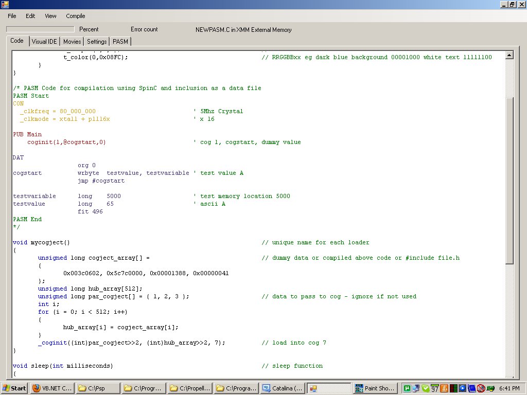

    Down the bottom of this thread I've posted the ram driver code. It uses the same instructions as cluso's driver, but the PASM is completely different. But very easy to use:
    OBJ
      RamLatches    : "Dracblade"                ' to talk to the ram chip
    then at the beginning
      r := RamLatches.start                                 'start the dracblade driver
    then set the high latch A16-A23 (512k uses A16 to A18, the other pins are spare)
      HighLatchByte :=%00000000_00000000_00000000_00000000 ' xxxxxxxx_nnnnnnnn_xxxxxxxx_xxxxxxxx where n is A16 to A23
      RamLatches.DoCmd("H", 0, HighLatchByte, 0)           ' set high latch byte A16-A18, plus led plus the 4 spare outputs
    then to write some bytes to a location in ram
    r := RamLatches.DoCmd("W", @buff, $FF00, 256)               'write 256 bytes from buff[noparse][[/noparse]] to sram location $FF00
    and to read some bytes from ram
    r := RamLatches.DoCmd("R", @buff, $80, 128) ' read 128 bytes from location 80H in ram to the buff array
    I hope there is a cunning way that could be useful for storing data in C

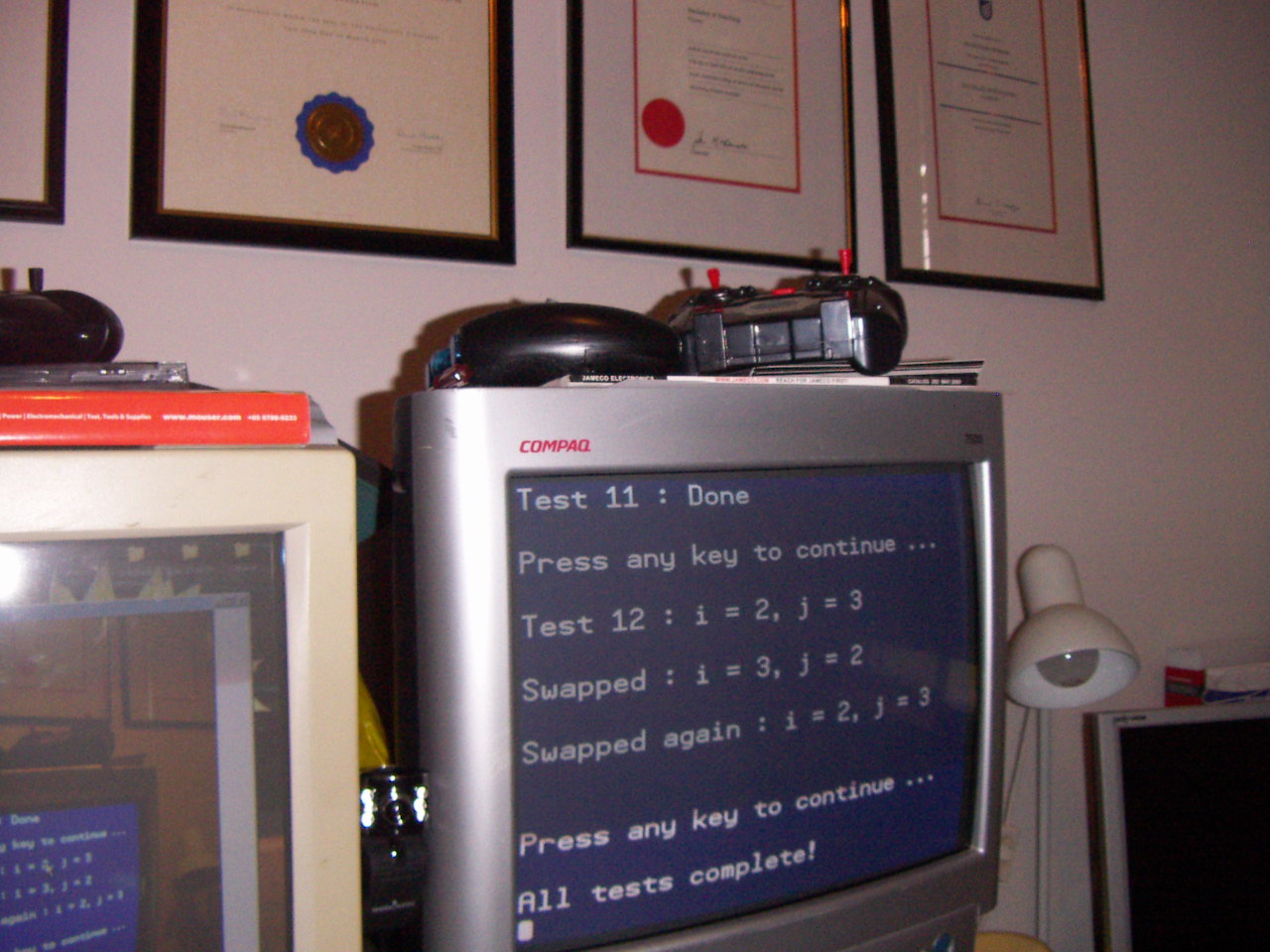

    The next program you might want to try is probably 'test_suite.c' - this is a trivial program that test a few simple C features (and also uses the keyboard).
    Ross.

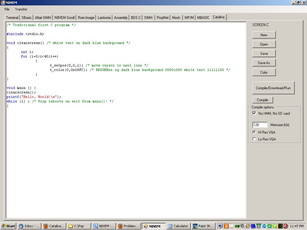

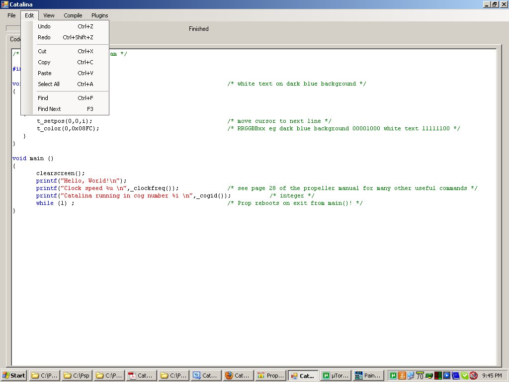

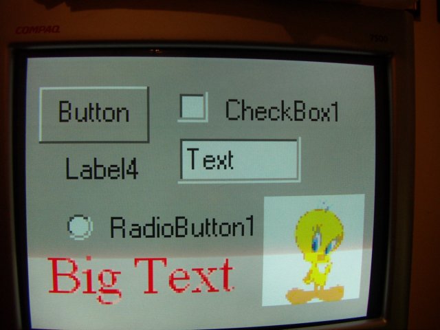

    edited 2010-01-22 00:48
    Test_suite.c works brilliantly. LORES_VGA is fine for the moment. (see picture at bottom of post)
    And I must say that this little program is a really good introduction to C. It is very helpful to see real world simple examples of code.
    I wrote a tiny batch file with a simple name so I can compile quickly. Called it TS.BAT and it contains
    catalina -D DRACBLADE test_suite.c -lc -D LORES_VGA
    So now the edit/download/re-edit/download cycle is down to only 5 seconds. That makes development fun!
    I wonder if you might be interested in adding in the LCD code? No hurry as I know other things are higher priority, but this is one of the nifty things about the dracblade - you don't need a VGA or TV if you don't want to. For small projects you can do a lot with a 20x4LCD (or even smaller ones), especially if you keep the questions and answers short

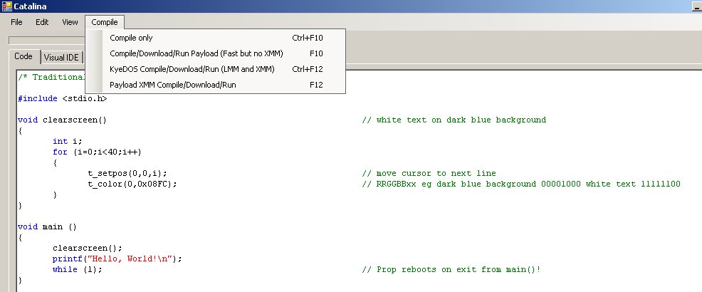

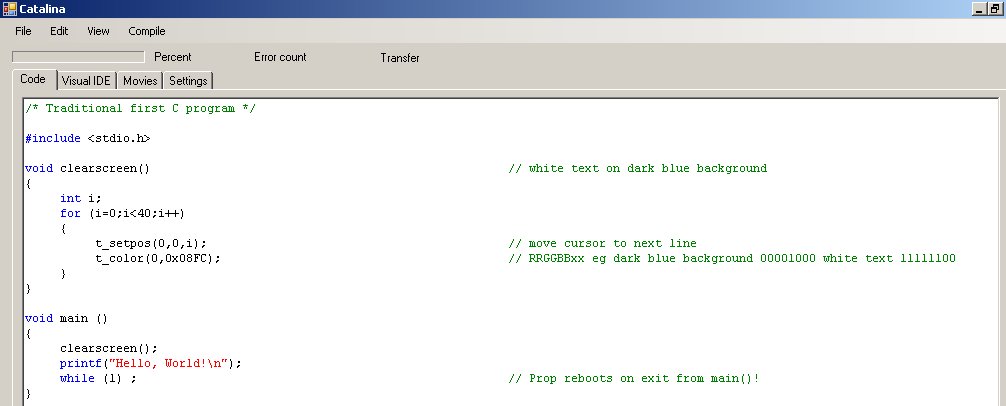

    edited 2010-01-29 13:13
    Woot! Got Othello working on the Dracblade. And other little programs as well. (@Rossh, no damage done by the patches, all was fixed with a Windows reboot rather than my usual hibernate/unhibernate. Windows needs a real reboot now and then).
    Minor problem - still bright green on dark green background.
    Ok, can you explain how to write a C program for a CP/M old timer like me?
    In CP/M the screen is whatever physical color it happens to be. Green on black, white on blue, etc. But you can change it if you want. Either with a call to some I/O ports, or with some VT100 codes. Those calls are usually the first thing in a program, right before the CLS clear screen and they are then followed by the text.
    But a Catalina program seems to leap straight into printing out text:
    Beginning C, Third Edition

    There probably is a way of defining screen colors within the program itself - for the dracblade it would be some OUT commands or VT100 escape commands.
    But I think Catalina defines it somewhere else. Looking at the vga driver code, I think the variables are passed via this line
    PUB start(BasePin, ScreenPtr, ColorPtr, CursorPtr, SyncPtr, FontPtr) : okay | i, j
    (the Dracblade CP/M emulation is using the same original VGA driver so I know my way around this one!)
    But what is setting ColorPtr? Is it set somehow with the command -D DRACBLADE
    And if so, is DRACBLADE a file somewhere or is it a series of switches in another source file?
    Anyway, at least we can play some games with Catalina on the Dracblade. Please forgive me if I don't post for a while *grin*
    www.smarthome.viviti.com/propeller

    This is fun!
    Ok, I edited that hmi driver
    #ifdef PROXY_SCREEN
    #else
      ' set up colors
      repeat i from 0 to rows - 1
        ' word[noparse][[/noparse]pscreen][noparse][[/noparse]colors + i] := %%0100_1310           ' pale green on dark green
        word[noparse][[/noparse]pscreen][noparse][[/noparse]colors + i] :=  %00001000_11111100  ' white on blue
    However, it hasn't changed anything.
    1) is %% octal or something - and hence is my binary code correct?
    2) Reading the ifdef, I think the above is only called if PROXY_SCREEN is false? What is proxy_screen, and if I'm not adding it to the command line, maybe it is false, and hence is the color definition coming from anywhere else in the code?
    Alright, I'm going crazy here. I saved that change and then went to find the file I had edited. Because the names are all so similar for those drivers, I went and resorted the directory based on when the files were last modified. A huge number had been edited at the same time - which was the time I did the last .c program compile. I figured - this is odd, only writing a windows file changes the edit time, not a read and a compiler should just be reading. So I went back to check my changes and they had gone.
    So to really test this out I edited out the lines above using the propeller tool and recompiled a .c program. The lines are back again!
    Are the spin source files self modifying or something? How do you make changes to them, or are you not supposed to?
    BUT ... maybe it doesn't matter, because hello_colour.c works fine, and so it would be much easier just to add these lines of code at the beginning of a program. See photo.
    Post Edited (Dr_Acula) : 1/29/2010 11:45:37 PM GMT
    1280 x 960 - 244K
  • RossHRossH Posts: 5,699
    edited 2010-01-30 00:11
    @Dr_Acula,
    Your change looks fine - I just tried it here and it works. But you are not editing the correct file (yes, they are self-modifying!). You have to edit Catalina_HMI_Plugin_HiRes_Vga_No_Mouse_Input.spin in the directory C:\Program Files\Catalina\target\input\. Make sure it has the _Input in the filename - you are probably editing the version in the target directory instead - and the compiler rebuilds this version on every compile from the input files. I realize this is a bit obscure - but it is documented in various places, including at the top of the file itself.
    The %% in SPIN means 'Quaternary' - each digit is 0..3, representing 2 bits. See the Prop manual for more details.
    PROXY_SCREEN is only relevant for multi-CPU Prop systems - it allows a program running on one CPU to use a display connected to another CPU. It's used on the TriBladeProp or Morpheus, but is not relevant for the DracBlade.
    Ross.
    Catalina - a FREE C compiler for the Propeller - see Catalina
