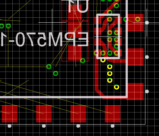

here is the challenge. How to program a device that has 6 pins without soldering on a header and taking up as little footprint as possible.

Best I have thought up is use a programing rig with 6x 0922-0-15-20-75-14-11-0 and have 6 1mm diameter pads on the board. some kind of physical alignment could be built to make aligning the programmer and the card.
Edge Connectors can not be used because there will be pins on all sides of board. Anyone else have a better suggestion?
I have a propmod-1x1 available as a price if anyone can think of a better way to do this(must be usable in my design)
vias in yellow are 4 jtag pins 3.3v can be easily accesed anywere on outside and gnd on inside of board.

    You can use pogo/test pins and a jig to make the connections directly to the IC or pads or vias.

    by pogo do you mean the part number i have found?
    ic is BGA so no physical contact to IC is possible.

    ok so same idea but the pogo pins have longer travel then the part i found. making programing rig will be fun. unlike spark funs boards my board has parts on both sides and parts hanging off the edges to.
    Still 1mm pads just fit in there. guess i will have to get board gold plated with this method.

    mctrivia, if the signals you want to connect to have pads or vias with enough space for the pogopins ( or something equivalent ) there is a simple way to make a programming fixture using two blank boards to make a jig for aligning the pins. It is simpler if the boards have mounting holes, but that is not required. If you are interested in details let me know and I will dig out the drawings and send them to you.

    There are many different kinds of pogo pin tips, each designed for a particular application. It's best to pick one that either self-centers (e.g. a pyramid or cone for via holes or a reverse cone for clipped leads), pierces the thin layer of oxide (e.g. a single or crown point for non-gold traces and pads), or both. Even with an alignment jig, these can be critical issues.
    edited 2009-09-08 20:13
    good thing to know. in this board i have almost know usable vias because i am using blind vias to allow the top side of board to be usable. i guess i do not need pads for vdd and vss since i can just connect to the pins.
    i was thinking for alignment and easier test rig could be made if i drill 2x 1.02mm wholes in opposite corners of the board. then i could just slide the board over 2 alignment pins.
