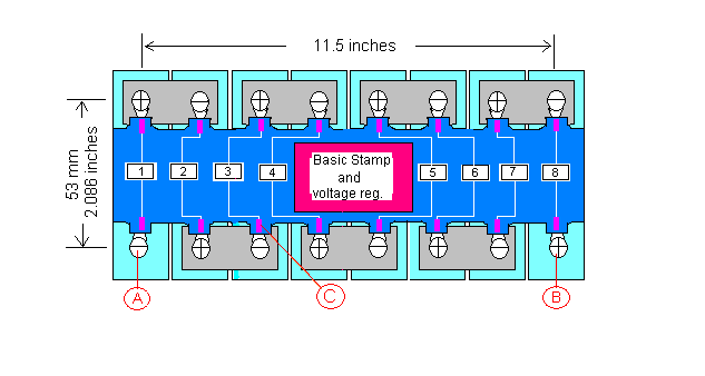

    Is it possible using multiple ADC0831 (National 8-Bit Serial I/O A/D Converter w/MUX) to read battery cell voltages while there in circuit ? In the picture below is a NiMh battery and a drawing of the proposed BMB or Battery Monitoring Board which would be attached to the top of that battery.
    Referring to the drawing the 8 blue-green rectangular boxes are the 1.45 volt NiMh cells connected in series is part of the 150 volt 102 cell Vectrix battery, the BMB is blue, large circled A and B refers to the battery terminals where the BMB is powered from there polarity is marked A negative and· B positive, small boxes numbered 1-8 are the ADC0831 and the large circled C is the one of 16 violet colored resisters.
    When the Stamp microprocessor uses #1 ADC0831 to read the cell's voltage there is no problem because the Stamp and the ADC0831 share a common negative. But when the Stamp stops monitoring #1 and starts monitoring #2 ADC0831 there becomes a problem, the negative connection of the ADC0831 is 1.45 volts higher then on #1, when it gets to the cell furthest to the right the difference is 10.15 volts. If there's no way that could work then is there another A/D converter that would be better suited keeping in mind that the maximum thickness that the BMB can be is about 1/4 inch.

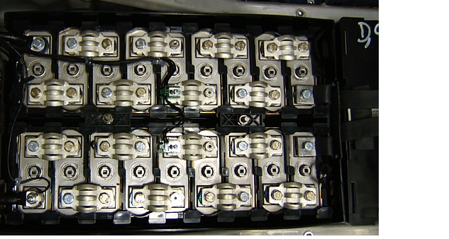

    To elaborate more on the battery it is actually two physical batteries connected together 150 volts with 102 NiMh 1.45 volt cells connected in series. In the picture below you see the top layer of a 3 layer stacked 54 cell battery and just to the right is the other battery you can see a little of which is the same except a shorter 48 cell battery. What I previously called battery packs are the 9 cells you see bolted together at there terminals, there are two in the picture. The other battery is lengthwise shorter and is only 8 cells long.

    Some quick comments about fundamentals.
    1. If the charge rate is too high, the battery pack gets too hot - so a I-wire thermal sensor (Dallas Semi) for each battery pack would identify which ones are overheating during charge and charge rate could be slowed. Overheating is due to severe charging stress.
    2. Measuring voltage with an ADC chip can be a bit of a challenge. When you get 8 channels on one chip, there is a lot of addressing options.
    3. Voltage is mainly useful as your indicator of discharge more than charge. NiMh should not be run much below 50% of rated voltage or they suffer severe stress. A dead cell may reverse polarity and self-destruct that battery pack beyond repair.
    4. It is one thing to monitor all these conditions for discharge, but charging taylored to individual cells is more complex.
    It looks like you would need about a harness of 18 wires to feed charging and I suspect that you would have to rotate charging in some manner where adjacent cells are not being charged at the same time (otherwise backflows from charging would complicate the process and cause damage.) I am not sure it can be done properly unless only one cell is getting charged at a time. You might start out with a low level bulk charge at first as a group and then do individual cells to top off.
