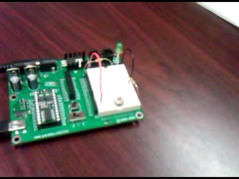

So I'm going through the "what's a microcontroller" tutorial, and ch3 (digital input) has a circuit to push the little button and have the stamp read the input signal and flash an LED as long as the button's depressed. Mine doesn't work :\ After fiddling for an hour I've figured out that when I turn the board off, then back on... it'll pretty much work for up to 8 seconds or so. It will indeed actually flash the LED as it's supposed to. But then it stops. And it won't work again after that until I reset the board. And if I reset the board, but then write the same program to it again, it won't work even if I haven't tried it yet since the last reset. At this point I'm pretty sure my programming logic works, since it does blink immediately after reset when I push the button. Why does it stop working/never works after writing to the board? I don't want to keep trying if I'm missing something stupid and jack up my stamp, but receiving input is kinda pivotal and all [noparse];)[/noparse] So I figure I'll put it down for tonight and ask you fine folks. Any help is much appreciated, thanks!

    Yeah, I've got a 470 Ohm in series with the LED. I'm using the same code and schematic as in the book, seen here on page 81 (page 90 of the PDF itself)...
    I'll post a pic (hopefully it shows up!) I took last night and never posted it because I thought it'd just be confusing (plus to further confuse things, now I've moved everything onboard to match the book exactly, just to rule that factor out) It's hard to see what's going on, but basically there's three long jumpers (black, red, green) from the board to an external proto board where I put the switch, just for ease & space. So hopefully you can see the circuit (and hopefully I didn't screw it up!) Like I said, now I've moved it all onboard to reduce problem factors, but still no go.
    Franklin, I see what you mean now about reducing the blink rate - like maybe it was just blinking so fast it was overtaxing the regulator? In the exercise before this one I had it blinking at 1 to 50 milliseconds on a for next counter, so it has blinked faster before and worked, but it's worth a shot - I'll try reducing the pause when I get home just to verify. I've been in IT for a long time, specifically programming for the last year or so, and at this point I'm getting the distinct feeling that I screwed something incredibly simple up - or there's a problem with the board :\

    As you can see in the pic provided, the OP has a Board_of_Ed and it·has a 7805-type regulator which supplies "V_dd" and he's using a wall-pack to run it.· So, there's no power issue as such.

    I see a problem here
    In the photo on page 81 show Vdd and the the 220 ohm on·one side of the switch ·and the 10k is on the Vss·of the switch and
    ·In the wiring diagram it show the 10 k and the 220 ohm on the Vss side· of the switch and Vdd on the other side of switch
    The one in the photo would make the INPUT HIGH when the switch is not pushed on a·NO switch and would not be LOW unless the button was pushed
    I have not· try-ed this set up to see how it really works but I will try it and see what happens the one in the photo
    ··Thanks for any·idea.gif·that you may have and all of your time finding them smile.gif
    Sam
