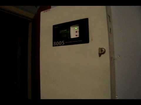

Hi,
I tried searching the forums, but didn't find anything on this topic.
How can I make a 24 volt Fire alarm control panel similar to this: ?
I'd love to have one, I'm great with electronics (ok, exceptional at least...), just need a little help. I messaged the user, but either he was just not in the mood to help me or he didn't get the message. Either way it sounds like I'm going to need a Basic Stamp EDU board, some relays, a breadboard, and what else??
I've left alot out of this original post, but feel free to ask any more questions that could help you help me. tongue.gif
-Tyler

    Look at some of Parallax's tutorials like "What's a Microcontroller?" and "Basic Analog and Digital" for ideas for controlling and sensing 24V signals.
    There's also the Nuts and Volts Columns. Column #6 discusses controlling relays and solenoids.
    Go to the main Parallax website and click on the "Resources" tab. You'll get a list. One item is a link to the Nuts and Volts index. Another is "Downloads". The tutorials are under "Stamps in Class Downloads" in "Downloads".
    As shown in the Nuts and Volts Column, you'll need some transistors or transistor arrays to control relays. For sensing a 24V signal, you could use a 47K to 100K resistor in series with a Stamp I/O pin.

    While this looks like a very worth wile project you need to concider a few things first:
    1) Define exactaly what you want your Fire Alarm system to do. Check out the Codes and Standards section of the NFPA (National Fire Protection Association.)
    ·························· http://www.nfpa.org/categoryList.asp?categoryID=124&URL=Codes%20&%20Standards&cookie%5Ftest=1
    ··· They set the standards for fire prevention safety in the US.
    2) Will you be willing to risk your life·with your project? The one you pointed out looks like it was wired on breadboard and not too high on the reliability ladder.
    ···· You would not only be risking your life but thoes family/friends/customers in your building.
    ···· Most electrical component data sheets state they are not intended to be used in life support systems. (Thats lawyers for you.)
    3) False Alarms: Most citys/towns have a policy about false alarms, and you pay the cost of the second false alarm they respond to.
    ···· In our town (Canaan NH)·it costs about $1,500 to send out the volunteer fire dept. (About the price of a commerciual fire alarm unit)
    I wanted to build my own Fire/Burgler/Freeze Alarm when·I built my new house 2 years ago. It is a piece of cake project for a Stamp.

    Mike has steered you in the right direction for the 24 volt interfacing. It is real simple.
    I have been interfacing Stamps to industrial machinery for 12 years.
    The biggest problem to avoid is not looking at the Sensors/Inputs while you are doing something else.
    You dont want to miss an alarm input.
    I use a polling routine where I service the inputs, but dont get tied up waiting for things to happen.

    Here's a guy http://www.youtube.com/watch?v=vcM6eUg1BwQ·that did it with Parallax parts.

    Thank you for your reply. I realize the risks, and will also have "backup" smoke detectors just in case. It is more for experimentation purposes than anything, and if I get it completely flattened out and working flawlessly, I may use it primarily...
