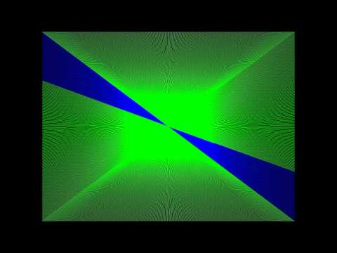

Ah, Morpheus! I haven't heard about that for a while. Your video looks pretty cool although the text scrolling looks kind of jerky. Is that a YouTube artifact?
I have the rev2 boards ready; I just have to write an addendum to the build manual to cover the changes - mind you, all experienced builders will need is the schematic.
The text scrolling is a bit jerky, but given that the bitmap is being scrolled in 512KB of external ram, its not half bad

First up is a YouTube 800x600 mp4 video of my graphics demo running at 800x600 with four colors (out of 256 color palette) per pixel.
I don't know how to embed YouTube videos in the forum, so here is the link http://youtu.be/FOpnMffHmxM
Updated URL for HD upload: http://youtu.be/XQoVsVe_Yac
(See message #280 later on the page for the embedded high quality video)
Please excuse the compression artifacts; YouTube re-compressed my MP4.

Put the link between [noparse][video][/video] tags, like this:
[video] which produces[/noparse]:
[video=youtube_share;FOpnMffHmxM]
I will try to improve the video quality.
I am about to try to upload 720p and 1080p versions of the video, hoping that will still leave much higher quality after YouTube re-compresses it.
This one looks MUCH better if you set your playback to 1080p or 720p, especially full screen
[video=youtube_share;XQoVsVe_Yac]
URL: http://youtu.be/XQoVsVe_Yac
(thanks Phil!)
