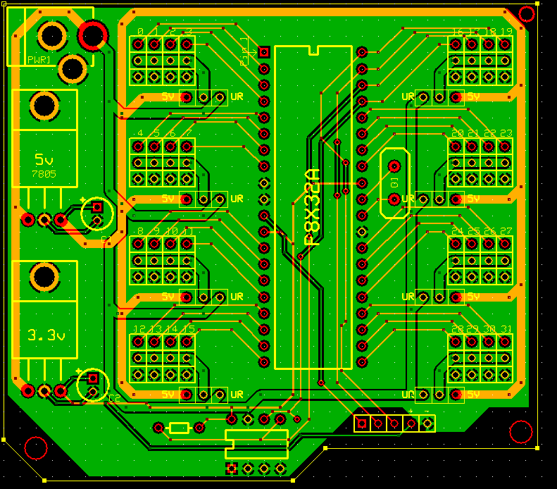

I have created a board in ExpressPCB and would like to have it made sooner or later. I'm not sure if I have all the connections correct though. could someone verify this for me, and maybe give me some suggestions for the board?
Thank you!
Brandon C.

    You should have some capacitors closer to the prop....

    Your 3.3V traces should be much wider. Also consider a 30v 47uf or more polarized capacitor on the unregulated power side. A diode on unregulated power will also reduce possibility of reversed input voltage destroying Propeller. Not that it matters, but your pin labels 16-31 are wrong on the servo headers ... they don't match the Propeller pins.

    I'd also suggest some resistors between the servo headers and the Propeller.
    Maybe a Power Switch ?

    I agree with jazzed on the 3.3VDD lines, thicker, caps right next to the Propeller VDD/GND pins (bottom side perhaps?).
    I'd also recommend putting some "fill" on the top-side under the regulator tabs for heat disapation - you may also want to move the regulators over so that the tab (which should be ground), isn't sitting on top of the unregulated input trace (read as "potential short after assembly")...
    To reduce the possibility of brown-outs, put a stiffening cap near the servo power jumper blocks (after the +5/UR selector jumper), and you may want to make sure that your supply and +power trace can tolerate the maximum load from all simultaneous servo movements...· You only have about the same thickness on the ground "plane" as the +5V line, there is a bit of fill at the top above the +UR via, and a tiny sliver of ground below C2 where it looks like you have a dead-end bottom-side trace...
    It looks like you have a dead-end trace hooked to one of the I2C lines from the EEPROM as well.
    I'm also concerned about the traces to the supply caps - they look a little thin.· Remember, they need to be nice and meaty so they have a low resistance and don't act as a resistive circuit component...· On that note, use the solid via-to-fill option, you don't need to use the cross type connection - especially for power...
    If power draw is not a big concern, add a status LED to the 3.3VDD/5VDD lines (as a reality check for·power supply outputs).
    my $0.02...
    -Tim
    [noparse][[/noparse]EDIT]· I notice, if you move the servo power selector jumpers a little further away from the servo jumper blocks, you may save a servo or two from mis connection - right now you could accidentally hook up +5/UR-GND-+5 on several servos, try to offset it diagonally so that the servo cable will absolutely not fit that way.· If you are looking for a way to get more ground width, move the servo power lines that go from the selector block (center pin) to the servo connector block (entire center row) up onto the top-side.· Also, the negative leads to the caps after the v-regs don't need a separate trace, you can just tie·the pad to the fill (which you already did) and omit the trace.· This will keep from breaking up the ground plane a bit.·-T

    I stared at it a bit more - and I'm remembering back to my early layout days...· I don't like how you did the unregulated trace around the bottom·of the board, but you did the +5V trace around the top...· You are creating a huge loop there, which isn't optimal.· You can improve that by routing the +UR·trace directly under (on the bottom side) the +5V trace (using the same path as the +5V trace too).
    Assuming you do the change to the servo power trace I recommended above (move to top-side), if you bring the +UR trace for the right-side servos down the right edge of your board, you will have a much better ground path for your servos on that side.· If you change your +UR trace·on the left side to simply jump from·the top selector block all the way down to the bottom (straight line), that should improve the left servo ground connection.· by running the +UR trace around the top, you'll have a nice thick ground fill around the bottom.
    Also, I question the header at the bottom (for programming?)· you have a "+" line that I think you intended to run out to the +3.3VDD output of the regulator (perhaps as a programming power·input?).· I remember a datasheet many years back where if you back-fed a linear regulator it would damage it.· With a lot of capacitance behind the regulator, you may want to put a 1N4001 diode across the input/output pins, to let voltage go from the output->|-to->|-the->|-input in the event the power is disconnected or you hook-up external programming power...

    I did notice that the pin labels are not correct. and the header at the bottom is for my serial adapter.

    Apart from the other comments, tracks should join other tracks at right angles. Having them join at an angle looks very untidy and can cause etching problems.

    The regulator pinouts are different for LM1086 or LM1117.

    I always try to 45 degree turns. I think it is just predudice from a long time ago. With toner transfer it is vital, but with read PCB manurfacture undercut shouldn't be a problem.
    As to the layout, Thr Xtal could be shifted slightly towards its pins on the prop and releive some of the bunching above it. There is a servo regulator very close to the Xtal could they be shifted more into the gap between the sockets? (towards the bd edge 90 degs round and one long heatsink could be used)
