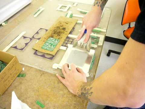

    The best technic I have found is to use a stencil, solder paste and a convection toaster oven.
    Stencils cost $20
    Toaster I paid $50
    Past I forget but not expensive and does lots of boards.
    Hoe to use.
    Place stencil over board
    Put past on 1 side.
    Use old credit card to draw paste over board.
    Remove stencil
    Place parts
    Pre heat toaster to 200 f
    Let boards sit for 4 min
    Turn temperatur to 325 f
    When elements turn off time 2 min
    Turn temp to 450f
    When solder starts to go molten time 30 second
    Turn off
    Bang toaster gently to let parts self seat.
    Open door and give 10 min to cool down.
    If no stencil use syringe solder.

    mctrivia, can you please explain more about the Stencils? (Keep in mind many who may read this thread may be rank N00Bs at this like me [noparse]:)[/noparse]

    There is a thread in sandbox on later cut stencils. Stensils are nicer but sering solder works well also

    i got my stencils made at: http://ohararp.com/Stencils.html
    here is an example of the file they need. this file makes the stencil for the top of all my propmodules.
    what would you like to know about them?
    @mctrivia: what's 'sering' solder - is it some form of solder paste?

    almost all components now are rohs compliant or exempt(lithium cells are except). there is no problems using leaded solder on them or unleaded. you are just not allowed to sell in europe if you use leaded.
    syringe solder was a type. it is a suspended solder that comes in a syringe to allow for accurate placement.

    > what would you like to know about [noparse][[/noparse]Stencils] ?
    OK, for those of us who've never done this...
    it looks like many of the stencils are made of a tradename polyimide film called "Kapton" 1), which is then cut using a laser, leaving reveals.
    Does the stencil make the pads?

    no the stencil does not make the pads. The stencil goes over the board and lines up with the pads to allow placement of the solder paste easily and acurately on the pads.

    RE Stencil solder paste placement, this guy makes it look easy, like buttering bread [noparse]:)[/noparse]
    mctrivia, you mentioned BGA chips just a bit ago,
    can you soldering one of those in your easy-bake [noparse]:)[/noparse] oven ? They look pretty intimidating!
    edited 2009-06-20 20:17
    yep. BGA are not that hard. I find they are actually easier then QFN if you place vias under the pads.
