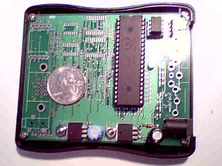

The quest to find my short(s).
I got one of my PCBs yesterday, and found to my horror the 3.3V rail was shorted to GND. The 2 layer board has decent 3.3V and GND planes, but to make it work some 3.3V traces dive and the etch margin can be narrow in the places where that happens. Given that, you might say "well, you asked for it!" [noparse]:)[/noparse] A visual inspection of the traces did not reveal anything obvious.
So, what to do? A short between power and ground planes is pretty horrible. Fortunately, there are traces connecting pieces of the planes, and a trace has a certain amount of resistance (if it was a 4 layer board, I would have been toast). You can't measure the resistance with a typical DMM to find the short, but anyone can use a battery and ohms law.
So armed with E = I*R: as resistance goes up and current is constant, potential difference voltage goes up. In this case higher resistance and voltage means bigger distance from the short. So, I connected my trusty old 6V AA battery pack on the 3.3V and GND planes for brief periods and measured the voltages.
Near the regulator section I had close to 160mVDC (no devices were installed during my quest). The further I walked my DMM probes from the regulator section, the lower the voltage went. Eventually, I found the area of least potential difference meaning that resistance was the smallest. Boy I had to carve a lot of area relatively speaking to get rid of the short, but fortunately, I only had to carve one place. The short was invisible to my naked eyes for sure.
So, having carved away the short from a small dumbbell shaped area, I stuffed some parts and verified basic Propeller function. Now I'm off to" Ace Components" around the corner on a parts list quest now that I found my shorts [noparse]:)[/noparse]
I've included a shot of the partially stuffed board for reference.
--Steve

  • MightorMightor Posts: 338
    edited 2009-06-16 20:02
    Jazzed,
    I think the coin on the PCB might be the cause of your shorts.
    Regards,
    Xander

  • jazzedjazzed Posts: 11,803
    edited 2009-06-16 20:04
    @heater [noparse]:)[/noparse]
    A friend of mine used to take shorted PCBs out to his car to pop shorts.
    I have only one board. Using a 12V 40+Amp battery was just too risky.
    @Mightor, Ya, I put too much money on my board [noparse]:)[/noparse]

  • RaymanRayman Posts: 16,460
    edited 2009-06-16 23:17
    Looks like a nice board. I like the case!· Is that the Sparkfun case?
    edited 2009-06-17 00:11
    @Beau, I don't have a thermal camera, but my shorts are a size 42+ so they aren't that hot [noparse]:)[/noparse]
    Is that a staple piece of equipment in manufacturing these days? I don't think I've ever seen one in an R&D hardware lab, and I've brought up many complicated designs. Usually the bigger company's I work for just send the boards out or have a flying probe before FABs are stuffed. I guess this is a budget learning curve for me. Wonder what it would take to make a thermal camera.
    @Ray, Yes it is. At $5 a pop it's hard to resist. Could mount the board on a boe-bot but with only two screws.
    --Steve
