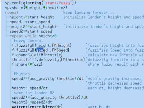

    Yes, Fuzzy Logic is integrated into ViewPort.
    It provides a complete, high speed fuzzy logic engine to help you control all sorts of things. I use it to balance my DanceBot. The demo tutorial shows you how to "land on the moon" with fuzzy logic. Others have used it to optimally charge batteries and more. ViewPort provides you with a nice user interface to help you understand fuzzy logic. Want me to put together a video?
    Hanno

    Finally completed the video of ViewPort's fuzzy logic engine and the lunar lander tutorial- see here for the thread:
    http://forums.parallax.com/forums/default.aspx?f=25&m=357686
    and here for the video:
    Hanno
