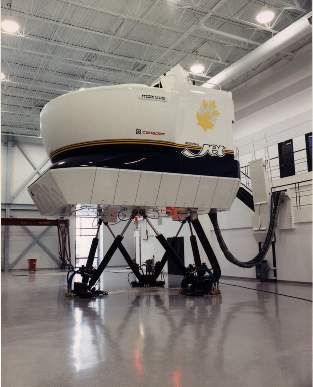

    stevenmess2004 covers it pretty thoroughly. Rather than trying to recreate the actual maneuvers of a plane, "real" flight simulators approximate the "feel" of being in a plane. For example, while taxiing, if you make a turn, the sim does not actually turn at all, it tilts to the opposite side as you are turning which tricks you into into thinking you are feeling inertia into the turn.
    A professional flight simulator uses 6 hydraulic cylinders to create an environment so realistic that the U.S. FAA can certify you without you ever setting foot in the actual aircraft.
    Here is a picture of such a simulator:
    http://www.linuxjournal.com/files/linuxjournal.com/linuxjournal/articles/033/3368/3368f2.png
    The 6 cylinder configuration shown can give the feeling of pitch, roll, yaw, buffet, acceleration, deceleration... the only thing it cannot do is a full roll... it'll try, though, by rolling up on to one side, then flipping around to meet itself on the other. Fun, but not exactly like the real thing turn.gif
    Given that you have around $5,000, and the pictured sim costs around $15 million (retail... includes mainframe to run the thing), I'm guessing you would rather have a close approximation... try pneumatics, they're a lot less messy, and you can get them through many car parts outlets.
