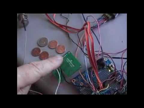

which is a direct conversion of the wiki equation but its in floating point (f is Float32) but I am already running Float32 on a cog so it isn't a problem.
I haven't tried it yet so I dont know whether it works or not.
I have attached the hp03 interface code I use if you are interested.

value := f.FFloat(BaroP)
value := f.FDiv(value,101325.0) '1013.25 * 100 since Pressure is * 100
value := f.Pow(value, 0.190263)
value := f.FSub(1.0, value)
value := f.FMul(value,288.15)
value := f.FDiv(value,0.00198122)
[noparse][[/noparse]/code ]
The program hangs at your value := section of code... any ideas ?
f.start
duhhh......
p I believe is in 'tores'
which is 957 in hpa
should be about 6500 feet
We are in the mountains !!

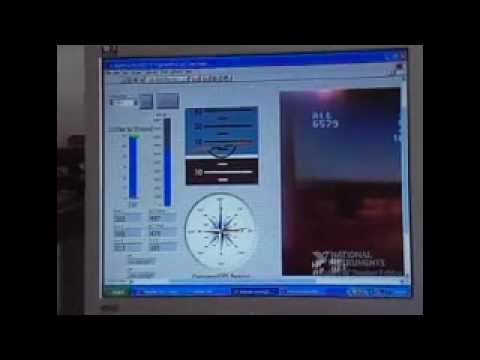

Oh....How about a live video window in the ground station ?
(See PIC)
Post Edited (Ole Man Earl) : 5/15/2009 1:37:14 AM GMT
The video window on the right of the instruments are coming from the UAV by 900mhz and inputted into the PC by a video USB adapter. Again , no physical connection.
You could be miles from the UAV and have complete control as well as seeing what it sees.
With the AP off, you control it by the 72mhz R/C transmitter. (if it would reach that far) Most R/C transmitters only have a range of 1/2 mile or less.
So how do we control the UAV from that distance ?
By the 2 way XBee radio of course! 2.4ghz from that altitude and 60mw of power should go over 10 miles. With a beam antenna, much further.
I need to develop software using Labview that will take a joystick input, convert it to data the UAV can use and send it to the servos, and squirt it out the XBee radio. Labview software can do this also !
If anyone has some experience with Labview, I could use the help on the joystick input and data output to the XBee radio. I just got my student edition of Labview and WOW, this is gonna take some learning.
This is what someone (me) can do by devoting 10-12 hours a day, 7 days a week, for about the last 6-7 weeks ! It has been quite an experience and a great learning exercise.
The guys at the coffee shop are asking me how I stay so young. I tell them by exercising my mind ! Now if I could exercise my body a little more.....
Not bad for being 63 and retired ! I hope to see all of you at the conference at the end of June.
