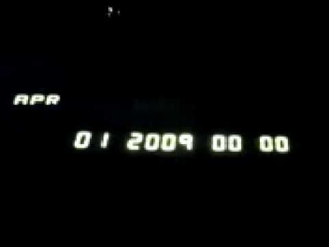

I am multiplexing 10 seven segment displays and 3 14 segment displays.
The display appears solid but I can still see visible flicker. The displays are "bouncing".

    The displays have flicker and I wanted to know how to get rid of the flicker?

    Usually if it flickers you are not updating it often enough. It also may be you are not supplying enough current but you should calculate that before just boosting the current levels.

    Nice job. Franklin is correct. You're not updating it often enough. I glanced at your code and my first impression is that you're trying to do a lot and there's not enough time to do it all. You need to refresh the display at least 60 times a second to avoid noticible flicker, that's roughly once every 16ms. A SHIFTOUT takes maybe 300us. A very simple statement like HIGH or LOW takes maybe 40us. Your main cycle takes on the order of 50 SHIFTOUTs, that's well over 15ms right there. You've got a lot of "PAUSE hold" statements and I'm not sure how they're interpreted. "hold" is set to zero (1/500), so the pause may be quite short. Without comments and without a schematic, I wouldn't begin to advise you on how to fix this up other than that the main cycle has to be more efficient and faster.

    The SHIFTOUT command can transmit more than 8 bits at a time and you·can use this feature to improve the efficiency of the SHIFTOUT command. Since PBASIC·is an interpreted language, each command is interpreted and then executed;·the execution time to send the bits in the SHIFTOUT·command·is pretty short.·Combining SHIFTOUT commands, where appropriate, can reduce the overhead associated with the interpretation.
    As an example, you have the following lines of code when you are writing to the LOWNIB of the variable [noparse][[/noparse]minutes]:
    DIRD=minutes.HIGHNIB
    SHIFTOUT SerData, Clock, MSBFIRST, [noparse][[/noparse]%11111110] ' send counter to 595-2
    SHIFTOUT SerData, Clock, MSBFIRST, [noparse][[/noparse]%11111111] ' send pattern to 595-1
    PULSOUT Latch, HoldL ' latch outputs
    PAUSE hold
    GOSUB clear
    You can combine the two SHIFTOUT commands in this example as follows:
    SHIFTOUT SerData, Clock, MSBFIRST, [noparse][[/noparse]%11111110,%11111111].

    That Did it. Combining the shiftout commands reduced the flicker.
