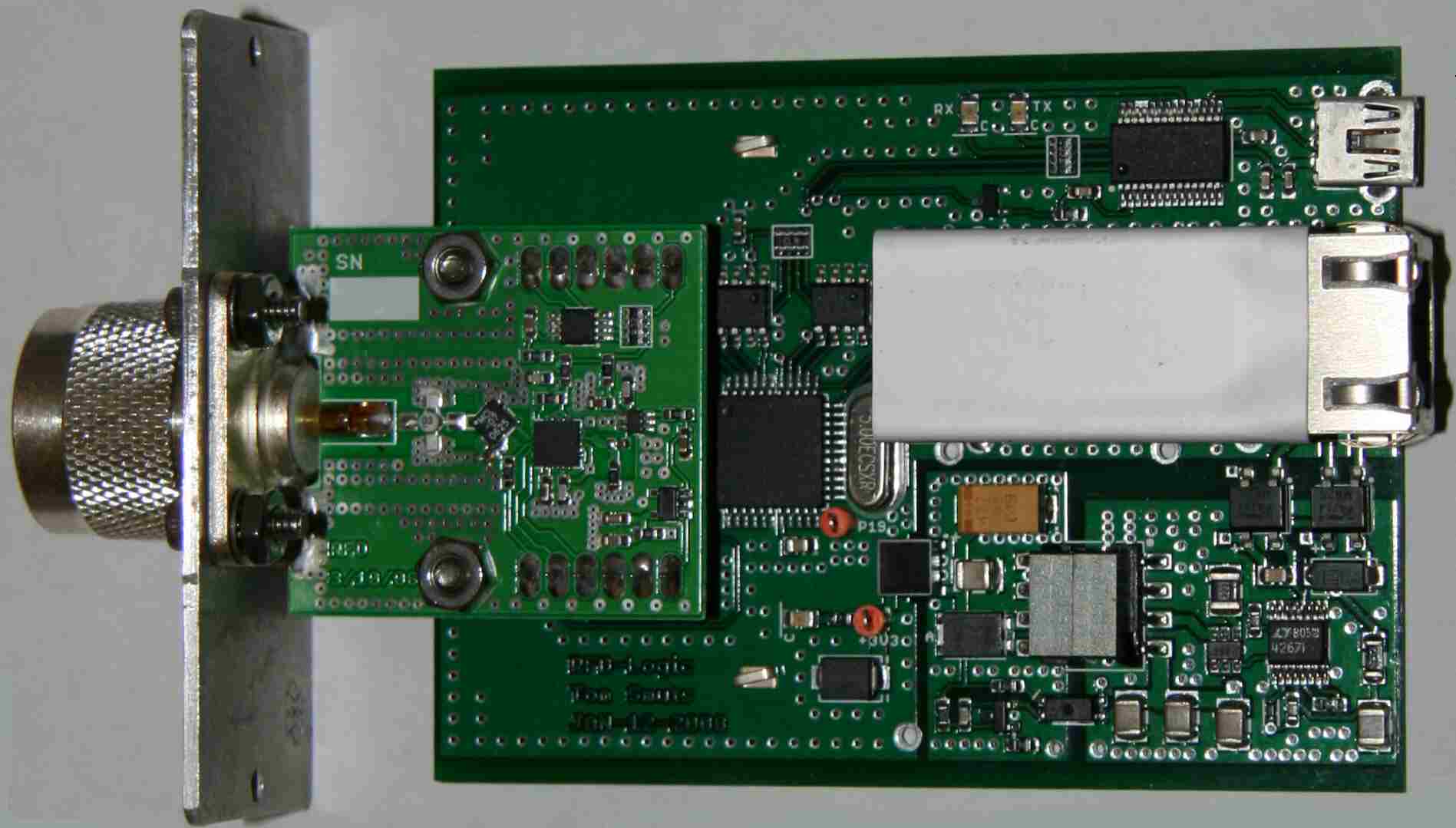

This seems to be the week for showing off our industrial apps so here's mine. It's a RF detector with dynamic range of 60 dB and a usable frequency range of 50 MHz to 2 GHz. It is temperature compensated. The interface is IP based and utilizes a XPortAR. I'm also using Power over Ethernet to provide the +3.3V needed by my circuit. Not shown is the custom extrusion it's housed in. I work in the broadcast industry and my device measures the power level of TV & FM signals through transmission line(s) to the antenna. Power levels range from 100 W to 200 KW.

    Very professional looking pcb and layout there Tom. It looks like the top pcb might be a commercial module from RFD perhaps or is it one of your own? How about the control board, is it multilayer and do you have a special pcb program to handle the RF side such as the extra via etc? That looks like a very small transformer for the LTC4267, what is the spec on that? It's opto is really small too, I don't think I have seen them that small.
    It shows that there are a lot of lurkers (effectively) on this forum that are doing some serious stuff! BTW, putting aside the technology I also consider 200 kW RF to be some pretty serious stuff smhair.gif

    Peter, The top pcb is my design. The substrate is Rogers 4350B and I've achieved a return loss greater than 30 dB to 900 MHz. Which is dammed good if I do say so. The main board is 4-layer and I used EAGLE to layout both boards.
    The transformer is a standard made by Coilcraft for PoE. I really hate to think about custom transformers for medium to small size projects so Coilcraft saved the day. The specific model I'm using is a POE30P-33L_. See these links for more info;
    http://www.coilcraft.com/prod_poe.cfm
    and
    http://www.coilcraft.com/poe_ep.cfm
    The optoisolator is a PS2911.
    200 KW is for mutiple TV xmtrs feeding a combiner and then split into two equal 100 KW signals in 8 inch line feeding a common antenna.
    Timothy, I love PoE. It makes power distribution a snap. And yes, it will be able to handle double the maximum power of the original spec soon. You may have to wait a while for switch manufactures to catch up though you could always build your own power insertion device.
    dMajo, You're right about the price being high but it was the only device I could find at the time with PoE capability. I could have used a xfmr but the total size was too great.
