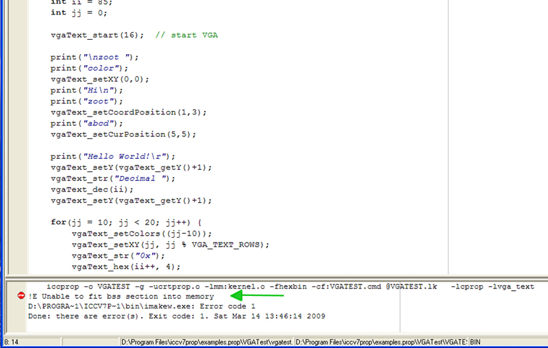

After discovering that Image Craft C is not to be some sort of bastard stepchild, I fired up the free download I'd started playing with a while back, and ran through the examples again. All was going well, and I remembered how much I enjoy the C language in general, until I hit the VGA Text example. That project wouldn't build. What the heck!? I don't remember that happening before. I did some fussing and fuming about compiler producers whose own examples don't even work... Then I remembered, the free download version has a 45 day limitation after which, as the ICC web site says,"it will be code limited for an unlimited time." It's actually decent of them to allow perpetual play, but when time expires for useful development, there's no message that says "Show me the money!".
I've attached the build error so anybody else who forgets how long ago they installed the download will understand what's going on before beginning a disgruntled rant.

    When did you download the ICC package?
    What version was this? Look at Help->About
    Have you added any files?

    I downloaded the package somewhere around Jan. 11, 2009
    Version info:
    ICCPROP
    Version 7.04 Built OCT. 27, 2008
    I have not added anything to the ICC installation folders... my own projects go into a folder on another drive. They seem to compile just fine... they're all just little play blurbs.
    Are you thinking that the build error may be more than an over-time issue?

    Reproducing a problem is key to solving a problem. How does your project window look? There should only be a few files; can you list them? If you could do Project->Rebuild All and copy/paste all of the text from the bottom output window in a post, that would be helpful. If your time has expired I guess rebuild would not be possible though. I've never had the trouble you're facing building just vga_text lib and vgatest.

    Please post your project build instructions. Creating a zip of your project directory and attaching it here would be very useful.

    I attached the zipped directory, but it should be exactly the same as you already have under "iccv7prop\examples.prop\VGATest". I have mine installed under D:\Program Files
    If you are running an "expired" version of the ICC free download, and VGATest is not giving you any trouble, it will be interesting to see if the version from my system behaves differently. If you are running a licensed version of ICC, then I would expect my files to work just fine. If they don't , that's interesting too.

    Well, since the project works fine for me and assuming all else equal (except that I had to find a copy of the vga_text.h file), I can only conclude that it's related to the expiration issue. Seems I remember now that on expiration, the application becomes "crippled" and memory size shrinks to 8KBytes or something.
    What were you using for ASIO library testing? I do not see that problem either. Since you can build it I assume it's not related to cripple-ware effects.

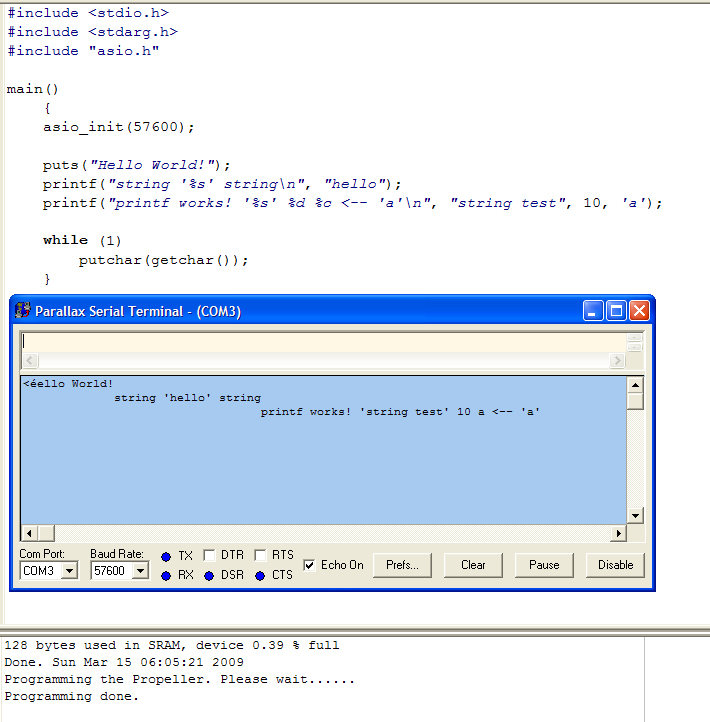

    Having received a proper license, and installed the latest version of the ICCv7 Prop compiler, I can say two things for certain:
    1. The VGATest project issue was simply the memory limitation imposed on the "expired" version I had been using.

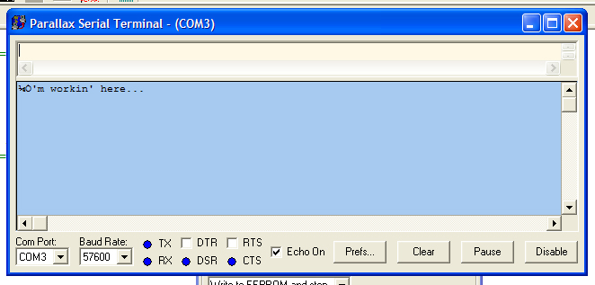

    2. ASIO is still not playing nicely. It always replaces the first character in a printf string with a garbage character, and the garbage character is always the same for any given string.
    For example (I'll use keyboard characters, the compiler puts control characters... or something) "Hello World!" will always come out as "@ello World!" but "Yo, Adrienne!" will always come out as "&o, Adrienne!". The garbage character is consistent for a given string.
    See the attached picture for actual Hello World output.

    Ned, I did the same thing yesterday and did not see your issue. I'm very annoyed by the linefeed problem though which I did not see before. One thing I had to do was put a delay after init so I could see all output after load i.e. msleep(1000);

    Three simple rules... and 2 out of 3 is not "good enough". Adding "msleep(1) ;" yes 1, is enough to distract it from squashing the first character.
    I am going to be boldly ignorant and ask, why the speed limitation? Spin, which is much slower, can push 115200, why can't ICC? I played around in ASIO.H a little, and managed not to break it permanently, neither did I make any real difference.

    Ok, hope the msleep(1) is an adequate work-around. I suppose the first transmit was happening fast enough after init to cause garbage. I usually put a getchar() or something before output to make sure I don't miss a thing since the port I use for comm is the same port I use for download ... Actually I was wondering if you have Protoboard or other dev platform.
    As far as Spin/C speed goes, if you are using FullDuplexSerial as a comparison, it is apples and oranges. The ASIO stuff bit-bangs relying on function call timing etc... (really a bad idea but mitigated somewhat by using waitcnt inline asm) where FullDuplexSerial is a PASM driver with queue called from spin. The ASIO equivalent SPIN Serial.spin code can barely do 19200Kbps ... I've tried many times trying to save program space [noparse]:)[/noparse]. The C FdSerial package is roughly the same as FullDuplexSerial. The FdSerial package is the way to go normally with ICC unless you're running out of space.

    Ned, You're in luck with printf ... here's an example of how to make it work:
    [color=#008000][color=#008000]/**
     * @file hello.c
     */[/color][/color]
    [color=#000000]#include <stdio.h>
    #include <propeller.h>
    #include <FdSerial.h>
    [b]void[/b] main([b]void[/b])
    [b]  int[/b] val;
      FdSerial_start(31,30,0,115200);
    [b]  while[/b](1) {
    [/color][color=#008000][color=#008000]   printf("Hello World\n\r");[/color][/color]
    [color=#000000]  }
    [b]int[/b] putchar([b]char[/b] ch)
      FdSerial_tx(ch);
    [b]  return[/b] 0;
    }[/color]
    Function putchar·is defined by default in ASIO and·vga_text though I wish they were not. You can also add FDS_DISABLE_OUTS·to the compiler options "Macro Defines" box to save space; it turns off FdSerial_hex, FdSerial_dec, FdSerial_out, & FdSerial_str.
    --Steve
