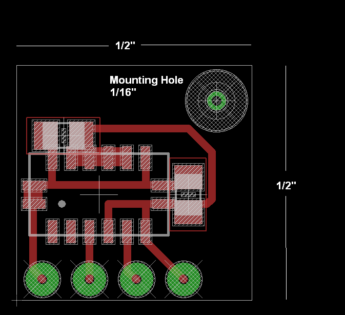

I got some LIS3LV02DL chips the other day and after 6 chip failures due to some bad solder paste, I've got the chip working, thanks to Tim Moore's object for a simliar chip, the LIS3LV02DQ.

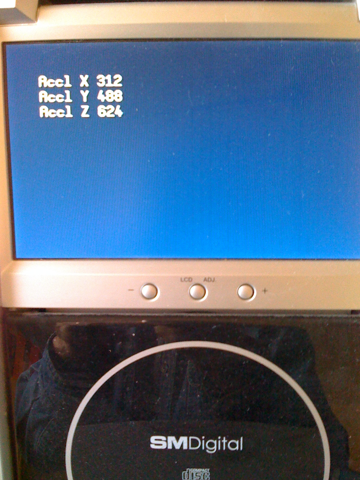

This chip is a 16-bit, triple axis, 3.3V compatible, VERY precise accelerometer. I'm looking at the numbers bouncing around(slightly) on my TV screen and I've got a big grin on my face. This really is an amazing chip, and I have sooo many ideas for it. The only problem is, they are rather pricey. No where near what sparkfun sells them for, but still pricey - about $8 a pop in small quantities. I want to order at least 15 for myself, but the price drop is at quantites of 50 or more. I've made a small PCB for the chip with a mounting hole, and 4 holes for wires. I've got a pretty neat method for soldering these tiny QFN chips, so I can take care of that. Anyone interested in some of these? I think I can get the chip, PCB, and the chip soldered, mailed, etc. for about $12-$15. There are a few other components that I have to solder on the board, but not too much.

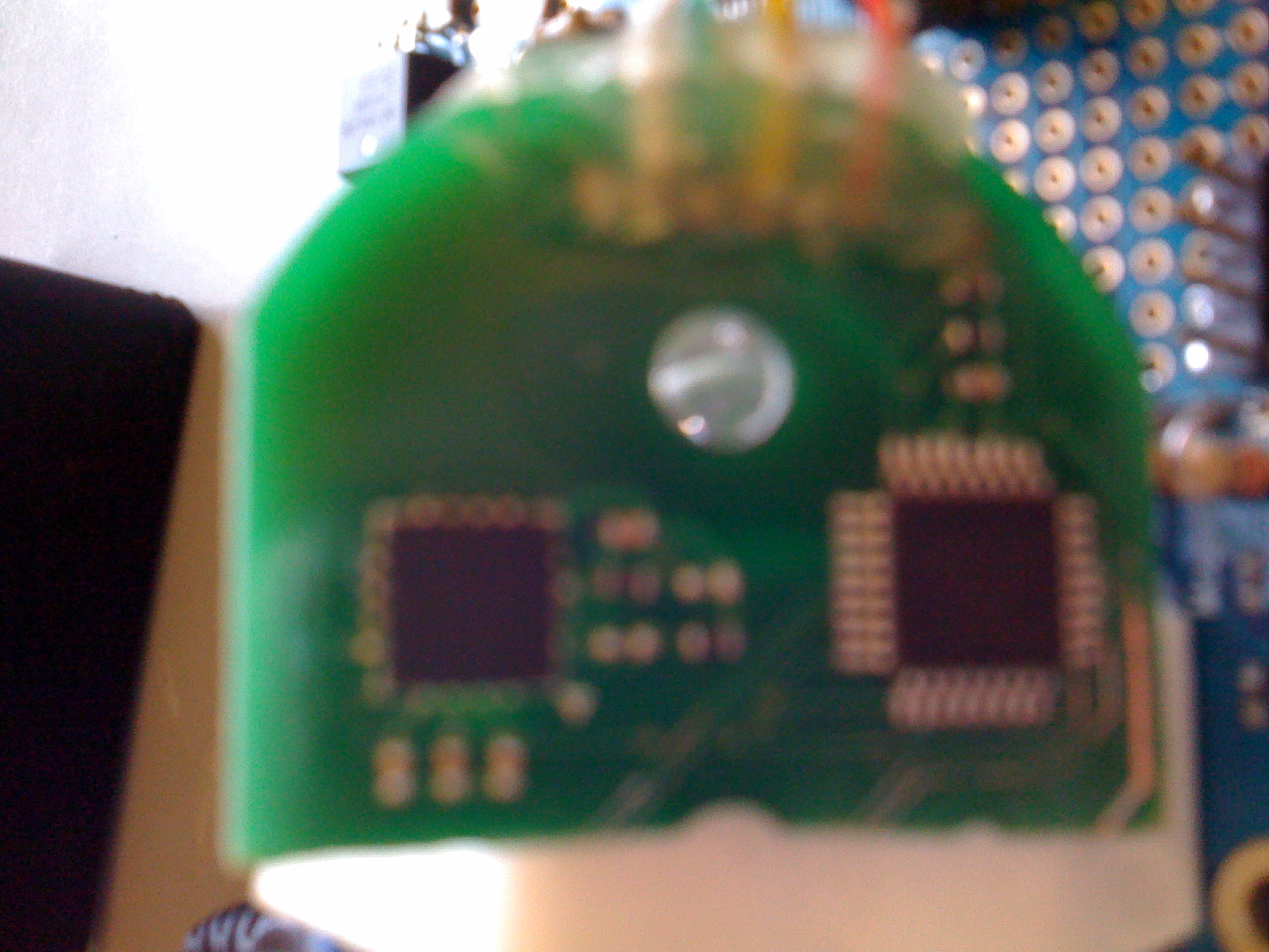

If you guys have any suggestions as to what the board layout should be, by all means, suggest. Right now, the board size is about 0.5" x 0.5". Pretty small... Also, the chip itself can be driven with i2c or SPI, BUT the object that Tim Moore wrote, works strictly with an i2c interface. This is why there are only 2 data pins, and 2 power pins. It's simplier and more compact that way.
Again, suggestions are more than welcome. By the way, I played with the chip for a minute after class today... I'm blown away by the sensitivity. I'm wondering if it's actually TOO sensitive. I mean, I have it on the floor, and my foot steps cause the numbers to jump around a bit - that's 3 feet away on carpet!

So, home-brewed boards it is. $5/each for the sample ones I have, and when I run out of those, $15 a breakout board w/ chip and caps soldered. I'll post a picture of the finished board tomorrow when school is over.

EDIT: Just FYI to everyone, I'm seeing about 1% jitter on each axis with the LIS3LV02DL chip. I doubt that's much of anything for a kalman filter to take care of... It seems the jitter also decreases in percentage as the acceleration is higher. When I have the thing sitting on my table, the X and Y have a fairly consistant 1% jitter, while the Z axis is more like 0.1% since there is more acceleration on that axis. Just FYI.

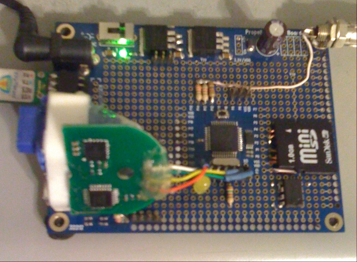

It also has a rocker ball and 2 push buttons if you want, But I cut the board in half (Cuts electronically very nice). So you end up with a board 1" x 1" with a 3 axis accl that talks to the world via SCL/SDA.
Now to write some code to talk to it !!!Nunchuck wires on the ckt board.....
