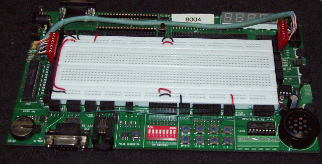

In light of that, one· way to quickly connect an LCD to the Professional Development Board (PDB) and enable the student to display "Hello World" on the display is to use a "wiring harness".· Jon's program above is an excellent example of a nice clean software design that the student can study also.
Photo 1 shows the PDB with the wiring harness in place (blue CAT5 cable across top and along left).·

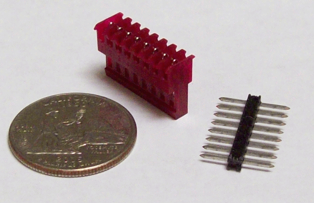

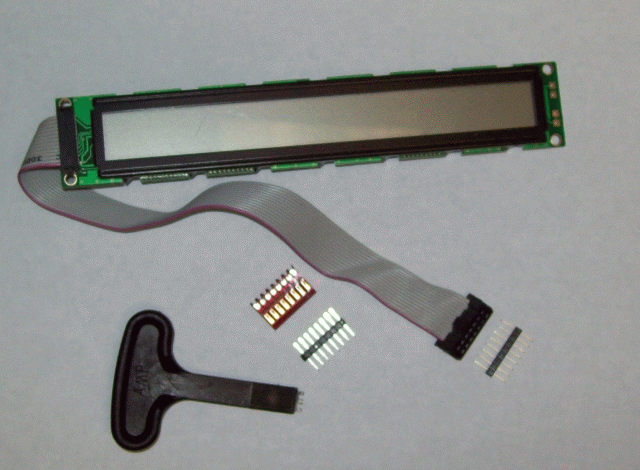

Photo 2 shows the 40 x 2 Parallel LCD modules that the college bought from All Electronics for about $6 each.· These had the cable and IDC connector already attached.· The nice thing about them is that you program them the same way as a standard 20x4 parallel module.· The photo also shows the red connector (see photo3) and the punch down tool for the red connectors (the tool is pricy at $21 but you can do the same thing with careful use of a small screwdriver.
Photo 3 is a closeup of the red connector and the strip header pins used to change the red connector from a female connector to a male plug.

1) Cut the pin strip header into groups of 8
2) Cut about 12" of Cat5 Cable
3) punch down the wires to the red connector, remember to punch the colors in the same SEQUENCE on both connectors.

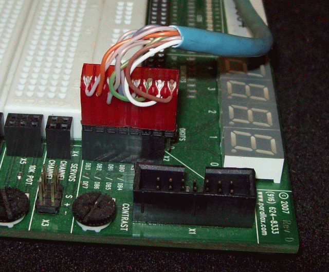

4) Insert one end of the cable into RC
5) Insert the second end of the cable into the X2 Connector (upper right on the PDB).· Now here is the tricky part.· The X2 connector is 7 pins wide and the Red Connector is 8 pins wide.· So you need to let one pin hang out.· Notice in photo 4 that the hanging out pin is the one that is connected to RC.0 on the other end.· Also note that the Red Connector is on the OUTSIDE pins of X2 (the inside socket connect to different parts of the LCD).
