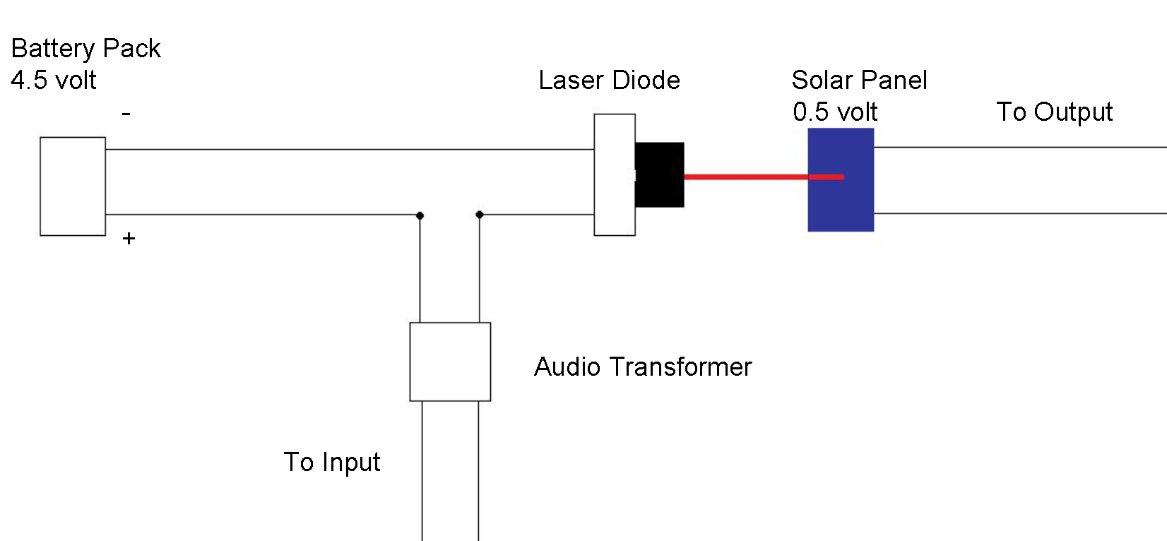

I have Drawn a Schematic for a Transmitter and Reciever.
How would you connect it to a Board of Education?
So it would use the BOE's Power Source Instead of it's own individual Battery Pack?

You could use a solar cell as a detector, but it's really not designed for that task. In particular, solar cells are designed for a broad response to light at several frequencies at least ... to extract as much energy as possible from the sunlight. Semiconductor lasers produce light in a very narrow band of frequencies. The most common ones produce infrared or red light and some more recent ones produce blue light. It's best to use a matching detector.
I strongly suggest not experimenting with lasers. They're potentially extremely dangerous and can cause permanent blindness in seconds and even fractions of a second. If a laser is on and comes loose, the beam can reflect off surfaces in the room and still cause permanent eye damage. Do your experimentation with a high output red LED. The problems are similar, the results can be similar, and it's much safer. I've seen (and used) a commercial infrared LED based wireless network transceiver with a range of about a mile, so you can do serious work with just LEDs.
