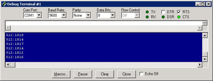

The PWM driver uses 4 states, meaning the lowtime and hightime parameters
should each be at least 2.
pwm frequency = INTERRUPTRATE/(lowtime+hightime)
Values for lowtime and hightime are inputted via terminal
(I used basic stamp debug terminal) like lowtime,hightime<ENTER>
The inputted values are then displayed by the terminal as
lowtime:hightime
Unzip the attachement in a folder and load DynamicVP_test_PWM1.SXB
in the IDE. The pwm signal appears on pin RB.7
Next step is to test the 32bit Timer VP.
regards peter

The ADC and DAC have an additional parameter that sets the resolution from 8 to 16 bits.
The attached picture shows the test program output using a 10bits DAC and 12bits ADC.
The fact that the ADC value is below 2048 for DAC value 512, is because of the circuitry.
I find the output value quite stable if you consider that the DAC is started and stopped as well.
The test program uses only 2 vpslots but 5 VP's, demonstrating starting and stopping
of VP's. Concurrently running are two TASKs using my alternative TASK implementation.
Just inzip in a folder and load DynamicVP_test_ADC3.SXB
It compiles for sx28 and sx48, but I have only tested it with a SX28.
(but I'm sure the program runs fine using a SX48).
Now I only need to complete its documentation although the documentation in
the DEF files should be sufficient.
regards peter

Just curious what terminal software you are using and where that might be found?
Cheers,
Peter (pjv)
I did a search on Google for the program and the search revealed it could be found on one of the Parallax forums.
Here is the link: http://forums.parallax.com/showthread.php?p=678480
Gary
I used the Basic Stamp Terminal which you can startup from
the Basic Stamp IDE. You can even startup multiple debug
windows.
@Sens-a-Dat,
Thanks for the link, but that is a stand-alone terminal.
It appears not to show the CTS state which the BS debug terminal
does show. In this case, for the included test program, that is
better as it shows that CTS is turned off while the SX transmits data
to the terminal (because the receive VP is stopped then).
regards peter
