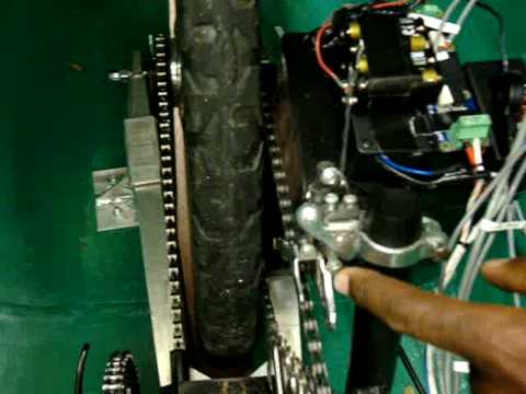

Ok, guys, here's the scoop. I'm a mechanical engineer here at Sacramento State University and I have been working night and day on this project and I am almost done.
It is a human powered vehicle with a power-assist drive system. Basically its a trike with a motor and its enclosed in a cool looking shell.
We have a 400W brushless DC motor with an onboard controller that only requires a 5K pot to control RPM. It also has a kill lead so that the motor can be shut-off.
We are powering that with a 24V LifePO4 battery that also has a onboard battery management system. I know....doesn't it sound easy already? NOT!
So there is a gearing system that the motor is attached to. A standard bicycle 7-gear magazine linked inline with the main drive motor. There is also a customized
deurailer that is shifted by means of a linear actuator driven by a stepper motor.
So the setup will be as such:

So. Everything works.
BUT....
Each section only works by itself. Not all together as a unit.
I wanted to run say the shifting in Cog 1, the other sensors and LCD display on Cog 0, and Data logging on Cog 3 (or any order)
When I attempted to run the LCD with the Voltage, Current, and 3 temps sensors on one cog and the gear shifting on another, it totally trips out.
I get garbage on the LCD and the shifting does crazy stuff.....I am slowly starting to lose it guys...this stuff is sooooo frustrating. And on top of that the final presentating is next thursday. Everything has to work by then....

I was thinking....is there a way I can pass a variable from one cog to the other one so that the other cog can do all the LCD writing? So with the above setup, the file HPV_HEADS_UP_LCD.spin right now only displays the values from the ADC which has the Voltage, Current, and 3 temperature sensors. If I could start that one in a cog and have the Gear_Change.spin start in a different cog, and have the gear value passed to the HPV_HEADS_UP_LCD, then I think that would solve my problem.....
How do I do that?
I hope that made sense..
cogs can share global variables just by the variablename ITSELF as long as there methods are in the SAME *.SPIN-File
this means if you define the variables that should be used by different objects in the same file as you define the objects
each object can access them even across cogs

LCD-Issue:
Another Idea is to create a Send_Data_to_LCD-object and define it in the main.spin-file
This object would work with a characterbuffer
This Send_Data_to_LCD-object ONLY reads out the buffer and sends the data to the LCD
and this object is the ONLY one who sends data to the LCD
ALL other parts of the program just WRITE to the characterBUFFER
If you can define fixed and different areas on the LCD for the two things HPV... and Gear_change nothing will go across anymore
if both objects use the same area (Row-columm on the LCD) you might get a mixed or overlapping output
of characters but not completely rubbish
this characterbuffer is simply an array of bytes
and has to be defined in main.spin

One cog calls on the object LCD_Write so that it can write to the LCD
At the same time, there will be another cog with a process that will call on the same object to write something else.
Aren't I going to run into the same problem of the two cogs trying to write to the LCD? Maybe I'm not understanding how the object call is going to be executed.
Really I want to do is process the Voltage, Current, and 3 Temperature sensors in one cog, get their values via the ADC and store that information into a variable so that I can 1. Display it on the LCD and 2. Store it into the Data logger.
In another cog I want the speed sensor monitored and gears changed accordingly and with that I want to pass the speed value and the gear value to be stored into a variable that can be passed to again the LCD and to the Data logger.
I understand that I might have to use pointers to reference address locations, but thats about where my knowledge ends.... I'm not exactly sure how to implement that in code...
