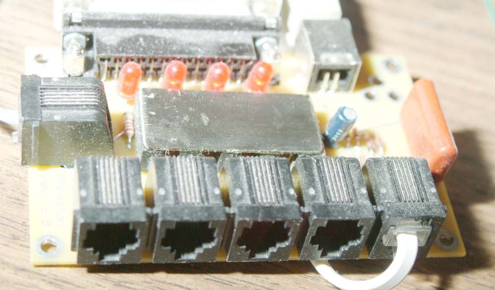

I'm attempting to use the HM55B with the Propeller Control Board mounted on a QuadRover and I'm getting an enormous amount of magnetic interference from the engine as its drive shaft rotates. Running the engine doesn't seem to help the situation, I had thought that with the magnetic field constantly in flux the compass might be able to read the background field though the engine's field. I can't imagine that Parallax didn't encounter this problem when designing the prop control board, there has to be a fix. I'm not sure where to go from here and neither is our QuadRover.

A magnet (or motor, or magnetized battery case) placed directly beneath the compass, or directly above it, or anywhere else near enough,·can affect it strongly.· If you don't believe this, experiment with a compass and a small magnet.· You will find its effect extremely strong, even when the magnet is directly above or below.·
Radar, sonar, etc. do not affect a compass at all, although the cables carrying power to them might affect it.· Degaussing is necessary because of the unavoidable magnetic field of the steel hull.· A steel object (such as a ship) under construction will acquire and retain a magnetic field induced by the Earth's magnetic field.· Its direction depends on where the hull was built, and on the orientation of the building ways (or graving dock, if it's built in one).
Degaussing coils are used almost exclusively on warships.· Their job is to buck the ship's magnetic field so that the resultant field near the ship (especially below it and, in the case of a submarine, above it) is cancelled as nearly as possible.· This is not done for the sake of the compass, which can be adequately compensated without degaussing coils.· The sole reason for degaussing coils on a ship is to prevent activation of magnetic detectors in mines and other ordnance (and in the case of submarines, magnetic detection by ASW vessels and aircraft).
Unlike degaussing coils we might use to demagnetize small objects (such as tape heads or screwdrivers), the degaussing coils on a ship do not demagnetize the hull.· Instead, they are constantly energized with DC in order·to cancel (imperfectly) the external field of the hull.· This is expensive and seldom worthwhile except on warships.

The problem is not correctly identified.
The problem is not that the compass is unshielded.· Shielding the compass will prevent it from working.
The problem is not that the motors and other magnetic field producers are unshielded.· Shielding them might solve the real problem, but may not be the best way to solve the real problem, which is --
The problem is that the magnetic fields from the motors, relays, etc. are getting into the compass.· That may not seem like much of an insight, but I think no one has seen it before.
Now then:· without shielding the compass, how do we keep these fields from reaching it?
(1)· We could shield each motor, each relay, etc., to confine its field· This would take a lot of shielding.· Mumetal would work, or soft iron (not steel) sheet.· Either adds expense, complication,·and weight.
(2)· We could, instead, enclose all that stuff in a single shield.· This would be even more expensive, make the thing hard to work on, and add even more weight.
(3)· We could seek to control those fields by steering them away from the compass.· This, I think,·is the correct tack.
Some time ago, I designed and built a telephone-call screener that controls who can ring my telephones.· This wonderful blessing works by using reed relays to connect telephone instruments to the Telco line when the call is welcome, and disconnect them when it is not.· The PC board that does this has five reed relays, side by side.· See accompanying photo (dusty, isn't it?· It's been sitting out in open air).
When first tested, the relays interfered with each other.· Every relay worked when no other relay was actuated, but when two or more were actuated the external field from one relay interfered with the function of any next-adjacent relay.· Oops.
The solution was to create·low-reluctance paths for the magnetic fields.· I did this by cementing a piece of soft iron (snipped from a PC expansion slot cover) over the whole row of relays.· The magnetic field from each relay follows a path through this piece of iron and doesn't go through the much higher-reluctance path that takes it through a lot of air space and through the adjacent relay.· It works.· If you look closely at the photo, you can see this little piece of soft iron in the middle of the board.· Under it are five reed relays that no longer interact.· Simple and cheap, and no redesign needed.
You can do the same thing with your motors and relays.· It takes only a narrow strip of soft iron around the waist of each motor to steer its external field.· For most relays, the strip of iron should be around each relay end-to-end.· The idea is to go from pole to pole of the coils that create the fields.· The effect is to short out the external magnetic field so that it doesn't desolate the entire countryside.· That countryside includes your compass!· It will keep the field away from your compass, and you don't have to shield the whole device.· A narrow strip, similar in cross-section to a popsicle stick, ought to work well -- subject to experiment.
Incidentally, it may also make the relays and motors work a little better.
No guarantees -- this is something to try, not anything I'd bet the farm on -- but it's cheap to try and it is very likely to work well enough to enable you to compensate that compass normally and make your day.
