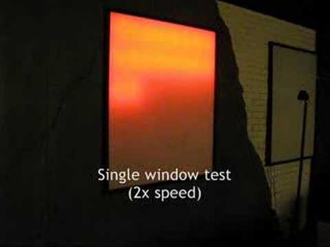

There are shift registers designed specifically for LED control, do you know about them? The one I like to use is the TLC5940 by Texas Instruments. The chip has 16 outputs and each output is 12-bit of control of the intensity of the LED. I used this chip to design the LED hardware for a couple LED mood lighting applications. This chip may be a little too fancy depending on your application. There are chips that at easier to interface too.
