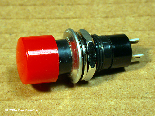

    Thanks everyone! PJ Allen, what's that IMG from? I'd love to get a copy of that 76+ page book! As well, my button has only two pins. Is there a workaround so that I can still somehow attach the 10k resistor?
    edit: my pushbutton looks exactly like this one:
    http://www.starshipmodeler.com/tech/bw_base/29PushButton.JPG
