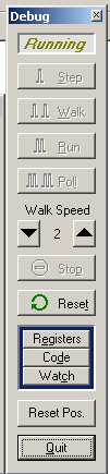

Can't seem to get my SX48 to debug at 3.0 volts. SXKey is at 5 volts. The thing programs (incorreclty???), but won't run or debug at 3.0 volts.
If bump the chip to 5 volts, it program, it·debugs, and runs as normal.
At 3.0 volts, the SX-Key software won't allow me to reset the device. Can't even tell if the chip is working. The SX-Key just starts up clocking the chip, without·giving me the·option·choosing·walk, run etc. ·It just starts "Running",·and all of the buttons are greyed out.
See attached image. Can't·run the other·hardware at 5 volts, Will burn up·IC's.
Also, note of interest, with the key at 5.0 volts and the Chip at 3.0 volts, the thing wouldn't program at the start of the day. It just said·chip connection failed. I needed to bump the SX48 to·5.0 volts before it'd accept any programming. Now, after that initial bump, it will program again at 3.0 volts.
Has anyone else here done any amount of programming/debugging of these IC's at 3.0 Volts?

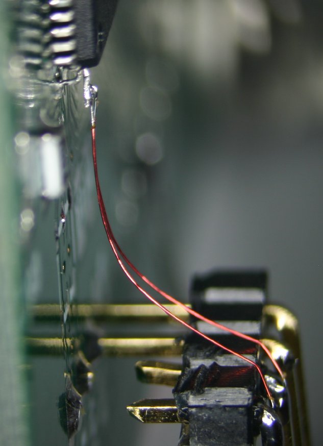

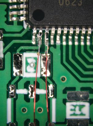

I tried to reduce capacitance by using point to point wiring. No luck, still won't work at three volts.·See attached images.
I didn't bother trying to calculate the capacitance, but I'm guessing it's pretty small.
A pair of #40 wires about .5 inches long each·at an average distance of about 1/16th of an inch...·· ...the C·should be small enough·[noparse]:)[/noparse]
-Dan

Last night, I was thinking about other things that I could be doing in code that could be problematic. I was wondering, can you post some of your initalization·code·(Just the directive/startup stuff?).·Basically I'd like to start with·the directives you're using, since they seem to be working for you. It would give me a starting point, to add a few lines to try debugging with.
At least, With the·Point to Point wires in the air, I'm comfortable it's not a capacitance issue, which is·one possibility eliminated.
