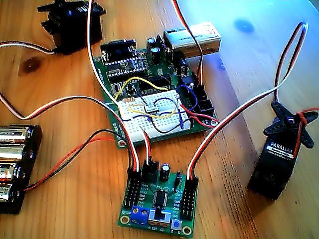

My PSC (serial) just came in the mail and I managed to get to the stage where the LED is actually lit (which is a tremendous feat for me), so I tried the source code from the Parallax PDF page.
' {$STAMP BS2}
'{$PBASIC 2.5}
ch VAR Byte
pw VAR Word
ra VAR Byte
Sdat CON 15
baud CON 396
ra = 7
ch = 11
DO
pw = 1250
SEROUT Sdat, Baud+$8000,[noparse][[/noparse]"!SC", ch, ra, pw.LOWBYTE, pw.HIGHBYTE, CR]
PAUSE 1000
pw = 250
PAUSE
I copied and pasted it exactly as is, and it goes to the same positon each time, no matter what numbers I put in for pw or ra. Can someone explain to me in simpler terms exactly what variable does to control a servo. shakehead.gif

    Can you post a photo of your setup?
    When the going gets weird, the weird turn pro. -- HST
    1uffakind.com/robots/povBitMapBuilder.php
    1uffakind.com/robots/resistorLadder.php
  • skatjskatj Posts: 88
    edited 2008-01-19 04:01
    I only have a webcam, so the quality's really bad. Tried to fix it up with photoshop a little bit.
    http://i137.photobucket.com/albums/q224/skatj/servosetup.jpg
    (ignore the stuff on the breadboard)
  • ZootZoot Posts: 2,227
    edited 2008-01-19 04:27
    Well, if you ran either your code or my code, I wouldn't expect to see motion on either servo:
    a) it sure looks like you have your servos plugged in to channels 14 and 15; the code sends changes to channel 11
    b) code only does one servo (11)
    In the PSC command, the ch var is the "channel" servo number 0 - 15 ON THE PSC.
    So... if the photo is accurate, try this. I'm getting rid of most variables, so you can hopefully see some results.

    1. Would you post the *exact* code and a picture of *exactly* the setup you have when you run that same code? That way we can at least baseline it.
    2. How are you getting power to the servos -- it looks like you connect the power leads from the AA battery holder into one of the servo cables?
    edited 2008-01-19 05:37
    I used your code (the one where you input a pulse), and tried both channels 14 and 15. I didn't change anything apart from those two digits. I took the photo of my setup shortly afterwards. Unfortunately I don't think I can get one of better quality, especially since it is night now where I am, so the lighting will be awful.
    I hooked up a battery holder with 4 AA batteries (1.5V each), to the positive and negative terminals of the PSC.
    edit: I tried the last code you posted, with the exact same setup. Both servos moved this time (expectedly), but to the same position as I described before. It seems like the connections and everything are in working order but I dunno..
    also, I don't know if this is significant, but the servos are locked in place while the PSC is on, I can't move the horn with my mind or anything, but then again that might be normal.
    Post Edited (skatj) : 1/19/2008 5:44:47 AM GMT

  • UnsoundcodeUnsoundcode Posts: 1,532
    edited 2008-01-19 16:21
    Is the red LED lit
    Did you check your communication set up with the version instruction, the code is in the PSC document.
    Did you remove the jumper that sets the channels from 0-15 to 16-31.
    If the above is OK try a fresh set of AA's for the servos remove one of the servos and just try and get one to work. Although you are providing power to the servos through one of the channel pins, which is fine, the PSC is designed to have the servo power connected via the small blue screw connector, but you may have a reason why you would rather use a channel connector.
    If you get past the above checklist Zoot's code should work
    Jeff T.
    edited 2008-01-19 19:50
    1. Red LED is lit.
    2. I ran the code from the PSC document, if that's what you're talking about, my firmware version is 1.4
    3. Which jumper is this? I have the red/black/white cable plugged into the left port, not the right one, but I dunno if that's what you're talking about.
    4. I have the battery pack soldered onto the pins under the blue screw connectors. The batteries are fresh out of the box.
    Okay, this time I tried using just one servo on channel 15. I used Zoot's code, changing 14 to 15.

    Hi skatj, the jumper joins two pins that are sticking up from the PSC circuit board on the right side of the large capacitor and above the "Inc" of Parallax Inc. It will likely be a blue or black small piece of plastic that you can remove with your fingers or a pair of tweezers. The jumper should be removed to use the channels 0 to 15. I'm at a loss to think what else the problem could be, your connections look good and you have already established that the comms are good.
    Jeff T.
    EDIT: I know you have this covered but I have to say make sure SW1 of the PSC is in the on position smile.gif
    Post Edited (Unsoundcode) : 1/19/2008 10:01:14 PM GMT
    edited 2008-01-19 23:23
    Baffling. Your servos have power, or they wouldn't turn. I would not try to turn a servo horn, though, on a servo that's "under power".
    The jumper unsoundcode is referring to will make the PSC answer to channels 16-31 instead of 0-15. If it's not installed, fine. But I do suggest you read the PSC documentation which discusses the jumper and so forth.
    You soldered leads to the terminal for power? Any reason not to just use the terminal block?

    I removed the jumper but nothing happened. If by 'SW1' you mean the off and on switch then yea that's on.
    I dunno if this is worth mentioning but when I move the servo horn out of its place and it goes back to its original position, the green LED doesn't flicker. It only flickers when it actually sends the pulse (I removed the do/loop from the above program to verify), but I don't know if that's normal behavior.
    Thanks for the help though guys, maybe I got a defective one or something =/

    The green light blinks during serial activity (when your stamp is sending data via SEROUT to the PSC).
    The blue terminal block lets you insert wires and tighten them down with the screws on top.
    Now, I think there *is* something funky going on here, because your setup basically looks OK, BUT I STRONGLY advise you to read through the PSC manual *carefully*. It has wiring diagram for terminal block, explains the jumper, etc.
    Additionally, you might want to download and check out "Robotics with the Boe-bot" and read the chapter on servo control -- it's a great a explanation of what servos are, how they work, and how to control them with microcontrollers.

    edited 2008-01-20 01:54
    Yes thats the document, the jumper is mentioned on page 5. If the jumper was in place initially that would explain why the PSC did not work at first.
    Strip back about 1/4 inch of the insulation of the servo battery leads, push them firmly in the blue connectors then tighten with a small screwdriver. As you look down from the top the red positive wire should be in the right hand terminal and the black negative lead in the left.
    The servo channel numbers·are printed on the PSC board against their respective pins, they might be difficult to line up at first so just double check you have the motor connector in the channel that matches your code.
    Jeff T.
    edited 2008-01-20 03:15
    Ugh, alright, so I tried plugging the PSC into a different servo port on the BOE, 12. I tried this code that you posted earlier.
    '{$PBASIC 2.5}
    Sdat CON 15
    baud CON 396

    And it worked! Then, after running it again three times, it stopped working. So um.. Yea. I really don't know. Is it possible I'm damaging something somehow?
    Also, looking at the PDF manual on page 3, the plastic jumper thing on the diagram appears to be on the Vin side, rather than the Vdd side. Is that correct?
    edited 2008-01-20 03:49
    What you say raises a point, be sure the servo supply selector· on the BOE is set to VDD and not Vin,is that the jumper you refer too. Setting that jumper to Vin·could damage the PSC.
    Jeff T.
    edited 2008-01-20 04:50
    OK, back up. When you mean page 3 of the manual you mean the PSC manual, but it sounds like you are talking about the Vin/Vdd jumper on your BOARD OF EDUCATION? Is that right?
    The jumper on your BoE must be set to Vdd if you are plugging the PSC into one of the servo ports on the BoE. The "power" that goes through the red wire from the servo port to the PSC needs to be the "regulated" Vdd -- which is a stable 5v. Vin is raw power from the batter and *could* damage your PSC.
    - jumper on BoE to Vdd
    - no jumper on PSC (so it responds to channels 0-15)
    - plug a servo into any channel on the PSC and run the code I posted most recently. Wait at least 64 seconds and the servo should move through it's cycle twice.
    - if not, triple-check your connections again and go through the PSC manual one step at a time. It can be tedious sometimes, but it's always worth it.
    edited 2008-01-20 05:01
    It was always set to Vdd so that's not the problem, the diagram in the manual looked different from mine so I was just asking to cover all bases. I ran your code before to no avail, I emailed Parallax and I'll just keep trying different things for now =/
    edited 2008-01-20 21:00
    Well, so here's what happened morning.
    I took out my stamp and ran some code.
    '{$PBASIC 2.5}
    ch VAR Byte
    pw VAR Word
    ra VAR Byte
    Sdat CON 12
    baud CON 396
    ra = 7
    ch = 0
    DO
    pw = 1250
    PAUSE 1000
    pw = 250
    PAUSE 1000
    LOOP
    (Channels and stuff were correct). And it worked, again. After running it a couple of times, it stopped working, again.
    I then tried your program that inputs position values through the DEBUG terminal, and that didn't work either. (I triple checked channels) In fact, the PSC wasn't even holding it in place. I could push the servo horn without any resistance at all. (the green LED still flickered though).
    So I turned it off and went to work on another project, and disconnected it from the stamp.
    And then...
    I heard a gurgling sound and I looked around frantically for the source - It was my battery pack: one of the batteries leaked a blackish liquid! My PSC was off and disconnected at the time, so I don't know if that damaged it somehow, but this makes me suspect that the underlying cause of all my problems is with the power. Any ideas guys? What does this battery leak mean?
    (All batteries were fresh from the same box, btw)
    Post Edited (skatj) : 1/20/2008 9:05:06 PM GMT
    edited 2008-01-20 21:12
    The batteries are probably shorted somewhere, could be where you soldered them to the board or maybe you forgot to switch off the servo supply. In some ways this could be a good thing, it's pointing to the probable cause why your PSC is not working. Try removing your solder joints and connecting the battery leads to the screw connectors.Unplug the servos and with no batteries check with an ohmeter between servo positive and negative at the blue screw connecor.
    Jeff T.
    edited 2008-01-20 21:21
    Unsoundcode said...
    What do you mean by this? I've been meaning to ask this, but is there some protocol on what to turn off when you're DLing a program? I usually turn off the PSC first, then switch the Stamp power back to 1, DL the program, then turn on the PSC and switch the stamp power back to 2, but I know there are times when I didn't follow this order.
    But yea, I'll try connecting the battery leads to the terminals this time.
    (I heated up the solder on the pins and sort of flicked it off, if there's a little solder left on them but they aren't touching the other pins, that's okay right?)
