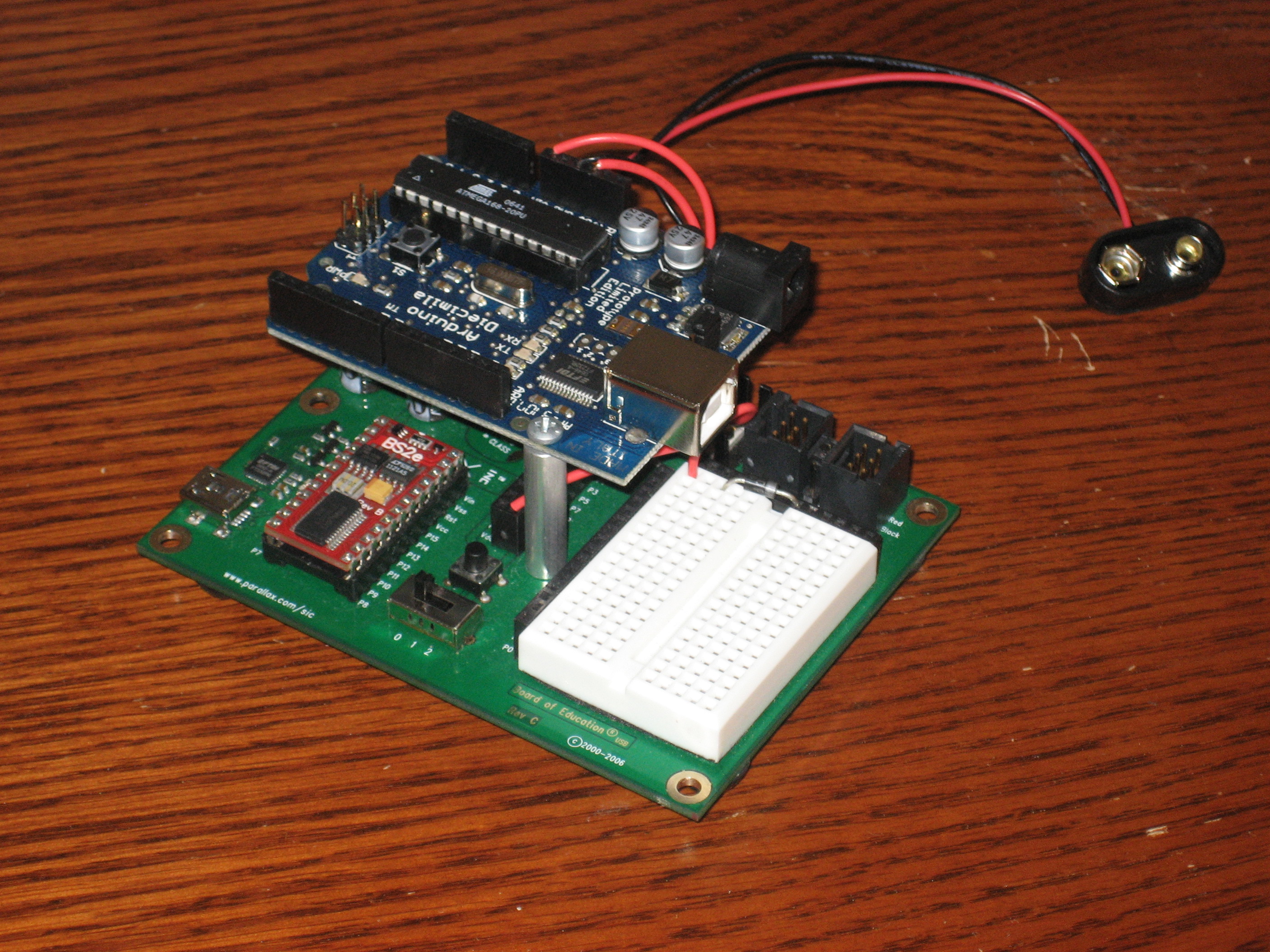

I had recently bought a BS2e, and I am now wondering about how to deal with matching up the baud rate with peripherals. Is the BS2e 16-bit? If I am communicating to a device that operates at 8 bits, will that not work? I'm not sure of what a description means by "operates at 8-bits". Maybe I'm using the definition wrong? I need to communicate via serial communication with an Arduino (it's an AVR ATmega168 microcontroller on a fancy dev. board). Here is some info some info on the ATmeag168: I think it can operate at up to like 115,200bps (but it is capable of operating at speeds the BS2e can handle), it is an 8-bit microcontroller, has a clock sped of 20Mhz max (although I think it's using a 16Mhz crystal...), and of course uses standard 5V logic for serial communication. Someone mentioned to me that the 'parity' needs to be the same (in the case of the BS2e, apparently, it has none), as well as the 'stop bits' (once again, it's apparently 1 'stop bit' in the case of the BS2e). I have no idea what those mean; I have never heard of those terms before. I tried to get the two microcontrollers to talk to each other, but the values are very skewed. The reason why I need to 'team' up the BS2e and the ATmega168 is because I need a lot of computing power; I just got a refurbished Roomba Red, and I am going to expand on a previous software design that the BS2e could not take on alone, and implement it with the Roomba hardware and ROI (Roomba Open Interface). In my case, the AVR is doing all the A/D and sensory input, and the BS2e is acting upon it. Is there a way to combat this communication problem? I have attached the [noparse][[/noparse]basic stamp] code, as well as the Arduino code. Of course, it is based off of C, and it is actually pretty easy to interpret; it has some of the same syntax as the PBASIC code structure. Ignore any 'commented' out parts (in the case of the Arduino, it's a '//'). Just for the heck of it, here's a picture of the 'brain stack', as I call it. This setup makes it easy to connect things between the BS2e and Arduino, and it holds them together.

  • UnsoundcodeUnsoundcode Posts: 1,532
    edited 2008-01-04 21:34
    It looks pretty close to working, you could try these minor modifications
    Stamp
    value···········VAR·····Word
    SERIN·Rx,·Baud,·[noparse][[/noparse]DEC4 value]
    Arduino
    Serial.println(DEC,·val);
    Serial.println(13);
    The thinking is to send a carriage return from the Arduino immediately following "val" and for the Stamp to be ready for a decimal value that might contain as many as 4 digits.

  • NoBo780NoBo780 Posts: 94
    edited 2008-01-05 04:12
    Awesome! It works! Thanks! I didn't think the solution would be that easy; how did you know to do that?? Before I close this thread, I have one final question: I am using the two micros to run a robot (or will be using, for that matter). I did this test for a reason: so one micro could input sensory data, and send it over a serial line to the other micro, which then makes decisions based on the input. Now, why did I do this, you ask? Well, I have an idea: if one micro is doing the input and decision making, and the other is receiving the instructions on how to act (the result of the decision-making), the 'act' part being, in this case, 'send this bundle of numbers to the Roomba' (signifying 'drive left' or 'drive right' or 'stop', etc), then that should speed up the whole system, as opposed to having one micro doing all the input, decision-making AND acting, correct? Or is that not true because the micro SENDING the sensory data is just as bogged down doing the serial communication (the sender and/or receiver) as it is doing anything else? Do you get what I'm trying to say? Correct me if I'm wrong. I originally was using JUST the BS2e as the main controller, but it got too overwhelmed doing 1) monitoring sensors, 2) driving servos, 3) making decisions, and 4) generating random numbers for the decision making. In this case, I am testing this scenario with a simple sound detection circuit running into the Arduino (ATmega168), which voltage level is then converted with the internal A/D, sent via (2400bps) serial to the BS2e, and then displayed in a DEBUG window run by the PBASIC software from Parallax. When I run it at 9600bps, and make it check every 10ms for a clap, it almost always registers it.
