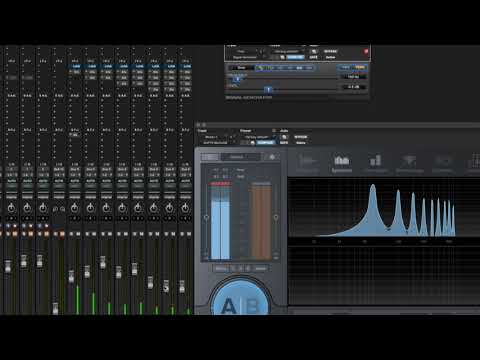

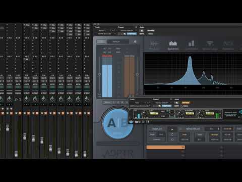

I have a 100hz sine wave that I am adding harmonics to with a tube/saturation plugin. I want to experiment with how different the harmonics look vs the fundamental to see what the simulation is doing to add/create harmonics that weren't there. I haven't tried to look at the output on a scope as it makes sense the scope can only show all voltages combined so it would not be possible to analyze a specific harmonic to see its shape compared to the original. For example how different will a 2nd harmonic (octave) look.
The first obvious though is to try to get a tight filter on the 2nd harmonic and try to view it on a real scope. Then test various waves ie sine saw square triangle. Maybe someone knows a better more accurate way to isolate a frequency and view its shape. The spectrum analyzer only allows so much. Even a square wave looks look a sine. The second image is an example of how what I want to see isolated on a scope.
  • That is not what one typically means when one speaks of a "scope." That's a spectrum analyzer. Scopes show the voltage change over time, while a spectrum analyzer tells all the frequencies present in the signal. Those aren't sine waves, they are overlapping peaks of energy centered on particular frequencies. They have that shape as a combination of imperfections in the sound source and the spectrum analyzer itself. Traditional spectrum analyzers work by sweeping the center frequency of a sharp filter across the frequencies, but the filter is never perfectly sharp and its response will contribute to the shape of the peaks. Some processes such as MP3 recorders take a small sample and do a digital Fast Fourier Transform instead of sweeping a filter.

  • Thanks for the info. Here is a video using 100hz tone and series of pitch shifters to achieve separate control of each harmonic. There is a second video that compares the pitch shifted separate "harmonics" to a saturation plugin.
