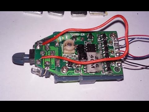

    Very hackable, erco's quite pleased. I "delicately" sliced open the hull with 2 slow circumferential cuts per the photos and everything pulled out very nicely. Mini 3xNiMH pack was socketed for easy removal, I replaced it with a LiPo and all's well per the video demo below. Ordering a few more for parts.
    I haven't range or smoke tested, but the tiny antenna is easy to extend and the SMT H-bridge driver transistors look beefy enough for a few hundred mA.
    @Phil: the red antenna wire is bent into a U and laying against the PCB. Both ends are soldered down, but the far end is not connected to anything. If you're range testing in salt water, you might want to drill holes strategically to pull out the antenna wire and reseal to try different antenna length & configs. How long is a 40 MHz quarter wave whip anyway, like 5.5 feet? :)

  • 'Back from testing. Yup, saltwater. It's conductive, and the radio waves did not penetrate more than a few inches. So in full dive and full forward, it would dolphin between the surface and 3" deep.
    I'll leave it to someone else to test in dangerous-drug-infested water. Who's up to the challenge? :)

    Would having the transmitter antenna underwater help? Connect a few feet of wire to the whip.
    Rather doubtful. I think it'd be like shorting it to ground.
    Better would be to mount a receiving antenna to a float and connect it to the sub via some thin coax.
