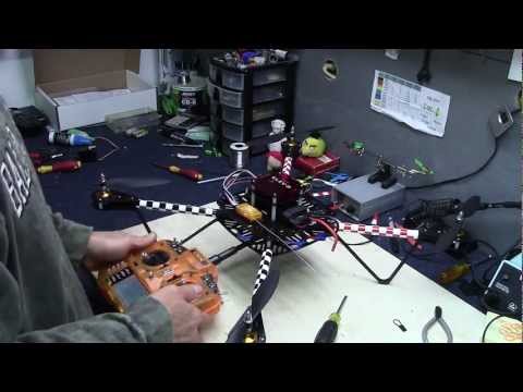

Hello! I have recently been building the Elev8 Quadcopter drone (version 2, I know, I am rather late for this whole party)
But I've come across a problem that I have no idea on how to fix.
And since I am not very experienced in building RC models, I suspect it will be a very beginner-ish problem.
Anyway, I am at the step of configuring the motor spin direction, where I plug in the ORX T Six transmitter and receiver.
The receiver/ motor should beep a while, then connect to the transmitter, then just start working, right? Without all the beeping?
Well, instead of connecting and going silent, the motor begins to beep annoyingly.
It's hard to describe in words, so here is a short video:
https://www.youtube.com/watch?v=lVle4U9ZhFI&feature=youtu.be
What on earth is happening?
May I please get some help with this?
Thank you very much!
Regards,
SpartanEngineer
    edited 2016-01-31 15:27
  • It's possible that whatever transmitter you're using has a reverse throttle range, IE the throttle goes from 2000 to 1000 instead of the other way around. (Older Futaba radios did this, and some newer ones do too). Plugging the radio in with the throttle up will generally be interpreted as either "enter program mode" or "set the throttle range", and either one will beep at you like crazy. :)
    See what happens if you put the throttle stick all the way up before you turn it on. If it behaves as you expect it should normally, just reverse the throttle channel in the radio and you should be good to go.

  • Hello! I'm sorry for the late update. I was rather busy for the last few weeks.
    After trying all your suggestions (swapping the ESC connected motor, reversing the channel input, starting with 'programming mode'), and none have worked so far.
    1. I did try to connect the ESC to another motor, and the motor to a working ESC - the conclusion is that the ESC is causing the problem.
    2. I reversed the channel input, but it still caused the same problem. I even tried to connect the ESC in reverse, but to no avail. I also tried to re-connect and reverse-connect the wires of the ESC to the battery - still no success.
    3. The ORX refuses to start with my throttle up - so I have no idea how to get into the programming mode.
    I think there is something wrong with my ESCs - perhaps they are faulty. If this is the case, is there a way around it? Perhaps re-programming the ESCs somehow? I really don't want to have to buy two more ESCs (or does Parallex have a policy where they supply new parts if the initial kit parts were faulty?)
