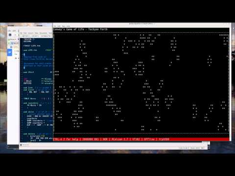

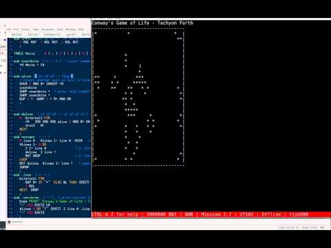

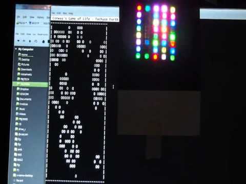

    edited 2015-08-06 21:42
    I did a quick hack last night on some Forth code I borrowed to play the game of life and it worked well. Now I've just tidied it up a little
    EDIT: Couldn't help but modify it again so that the bits in each cell are displayed vertically for 32 lines and now the "lines" constant is used for the width. In this way we can also specify the width at runtime<br> video
    <br>The code size is 541 bytes including pattern setups with 284 byte in dictionary space.
    The nextgen function executes in 57.6ms and the .universe function takes another 17.4ms (non-buffered).
    EDIT: Updated the latest EXPLORER binary to include LIFE - runs at sedate 115200 baud - just type "demo"

    (This post should just about crack the 250,000 views mark! )
    edited 2015-06-01 16:03
    Congratulations Peter! You have cracked the 250K views :)
    edited 2015-06-02 06:12
    Cluso99 wrote: »
    Thanks, I thought it was crazy when once it had 10,000 views, and that was after only 2 months!
    As for the game of life, how wide can you set your serial terminal screen? 128 characters? How about 476 wide! :)
    For my 1920x1080 screen that means that characters must be around 4 pixels wide including spacing!!!
    1019 x 201 - 29K
    268 x 93 - 6K
